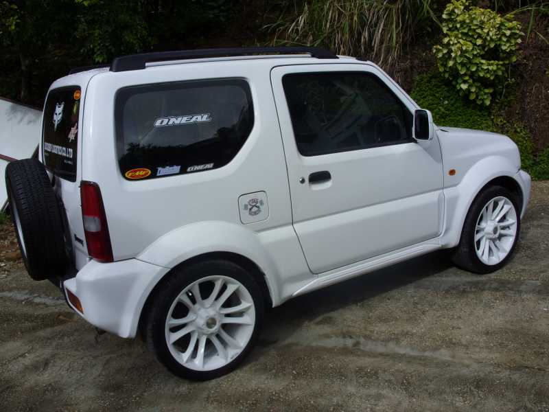

05 May 2015 04:55 #143697
Replied by Lambert on topic lowered jimny?
I'm liking that. Apart from the stickers. And being white.
