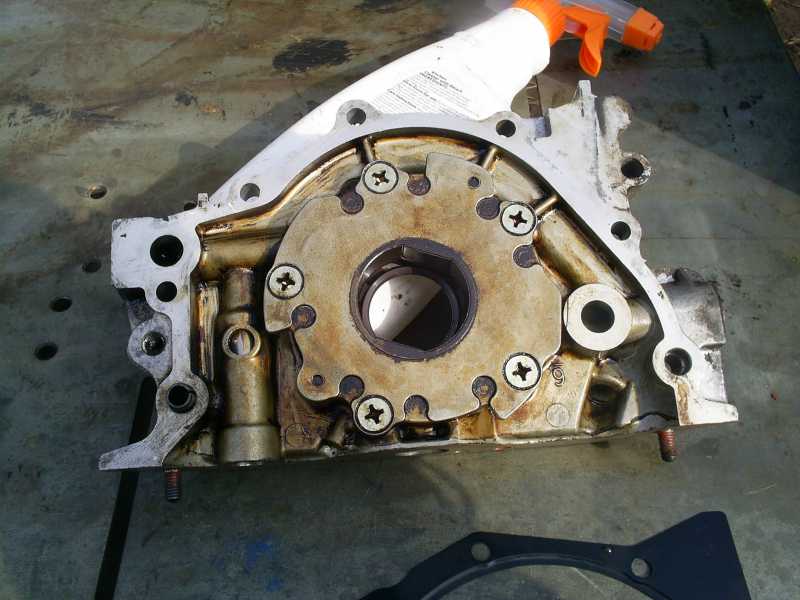

Has anybody ever taken off the cover that the oil pump is mounted to. This is the one that the crankshaft sprocket goes through with the replaceable seal. I have removed mine as I am trying to source and fix a long on going history of oil leaks on the car. Upon removal there was what was the remains of a paper gasket but it was in pieces and was very brittle. I have a complete gasket set for the G13bb engine and although it is for a Baleno the engine is basically the same. This set has a cork sump gasket as the Jimny does not use one is one difference. Looking for the oil pump gasket and I have found that it is steel. I have been on to the dealers and they report that if you were to order the oil pump it comes with the panel but the spares catalogue does not show a gasket per say! So from the photos you can see the panel and steel gasket. There appears to be a crush area around the panel. Has anyone ever used one of these on the jimny with success?

I've no experience with this but I'd run the metal gasket, it is a similar design to some head gaskets, usually the coating acts as a sealant. You need to make sure that the mating faces are clean and then follow the torque requirements in the Baleno FSM.

Thanks for that Rhinoman. I do have gasket paper so I might make one. I would like to use the metal one but it is quite a job in situ if it leaks. I will decide eventually what to do.

I would probably use a good gasket sealant and thats all.

I am old school and find that using that stuff seems so unprofessional. I would much rather use a gasket with either blue or red hylomar. When that stuff first came out it smelled of vinegar!!
