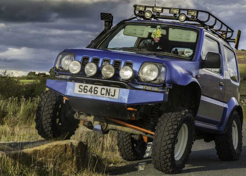

Starter motor! Undoubtedly James on here can sort out a second hand one for you!
James, this chap needs a starter motor for the car in the picture!
