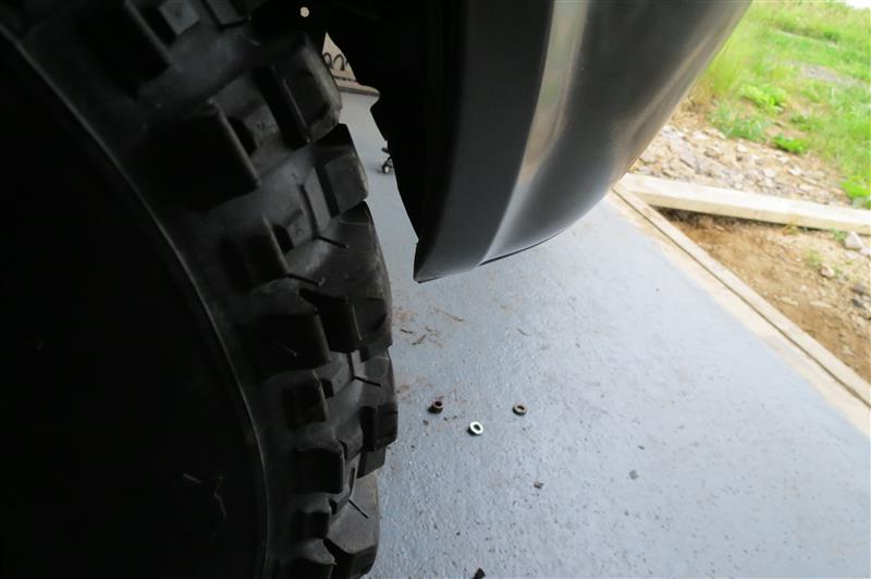

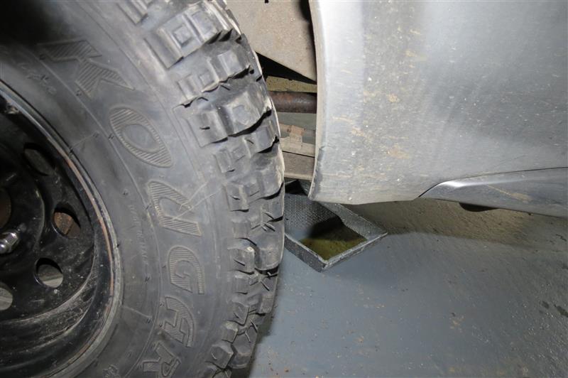

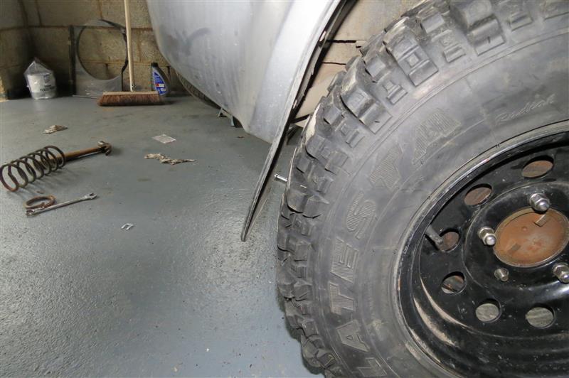

A few weeks ago I picked up some cheap Maltesta tyres in a 215/80 mounted on a 7" rim with 100mm backspacing. I got them on today after fitting a 2" lift and they are huge, lots of clearance problems.

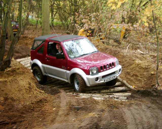

On my old Jimny I had the same size tyre, 215/80 made by Colway, mounted on 5.5" SJ rims with 95mm backspacing and no suspension lift:
Both sets of tyres are remoulds. I'm not fussed as the Maltestas will go on another vehicle and the rims are as good as new so I'll reuse them with a new set of tyres. The original 5-spoke alloys are destined for my SJ413 pickup. I just thought that the pics illustrate nicely the problem of simply quoting tyre sizes.

I think its mostly the width of the rims that's causing the issues, according to the tape measure the height is about right and moving the outside edge of the tyre in would give a lot more clearance. The Maltestas are going on SJ rims so I will try them again when they've been remounted.
14 Jun 2014 14:10 #117847
by Busta
Replied by Busta on topic Tyre sizes and how they differ
Yes, the wider rims with only a little more backspacing will move the tyre out towards the edge of the arch. You need 115mm backspacing to put the tyre in the same position as on the narrower rims.
14 Jun 2014 16:37 #117851
by Rhinoman
Replied by Rhinoman on topic Tyre sizes and how they differ
Well I've taken a tape measure to the tyres, the stock 205s measure around 200mm wide. The 215s measure around 235mm wide! they are clearly marked 215 but appear to be closer to a 235/75 in size, combined with the 7" rims they stick out a lot further than the old 215 Colways did.
