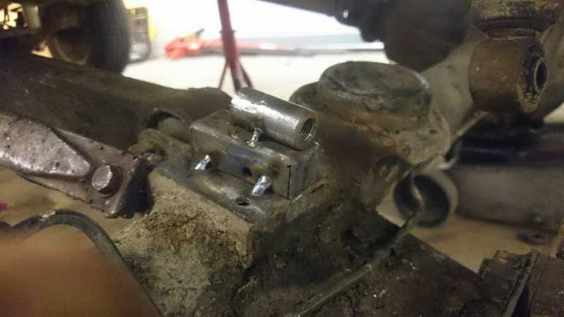

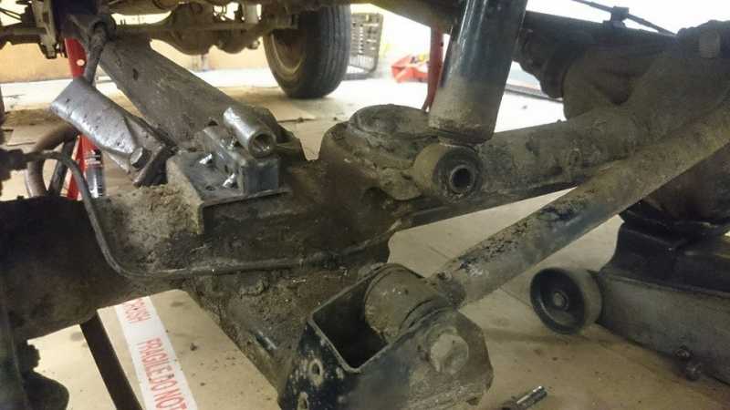

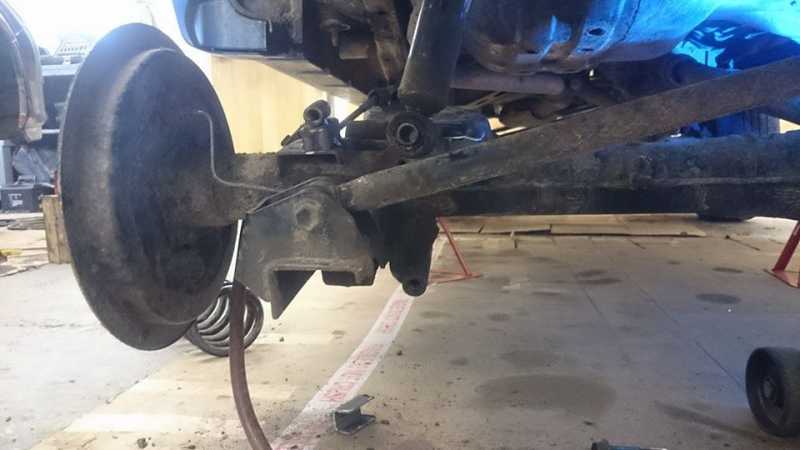

  • Alliston
14 Jan 2014 19:50 - 14 Jan 2014 19:51 #100576 by Alliston
Replied by Alliston on topic Rear shock locators?
I welded new brackets on top of my axel which gives me better articulation I have also fitted a 2 inch lift by fitting ford focus estate springs but kept old shocks on back. the older brackets hang to low. What do you think ????
Last edit: 14 Jan 2014 19:51 by Alliston.
