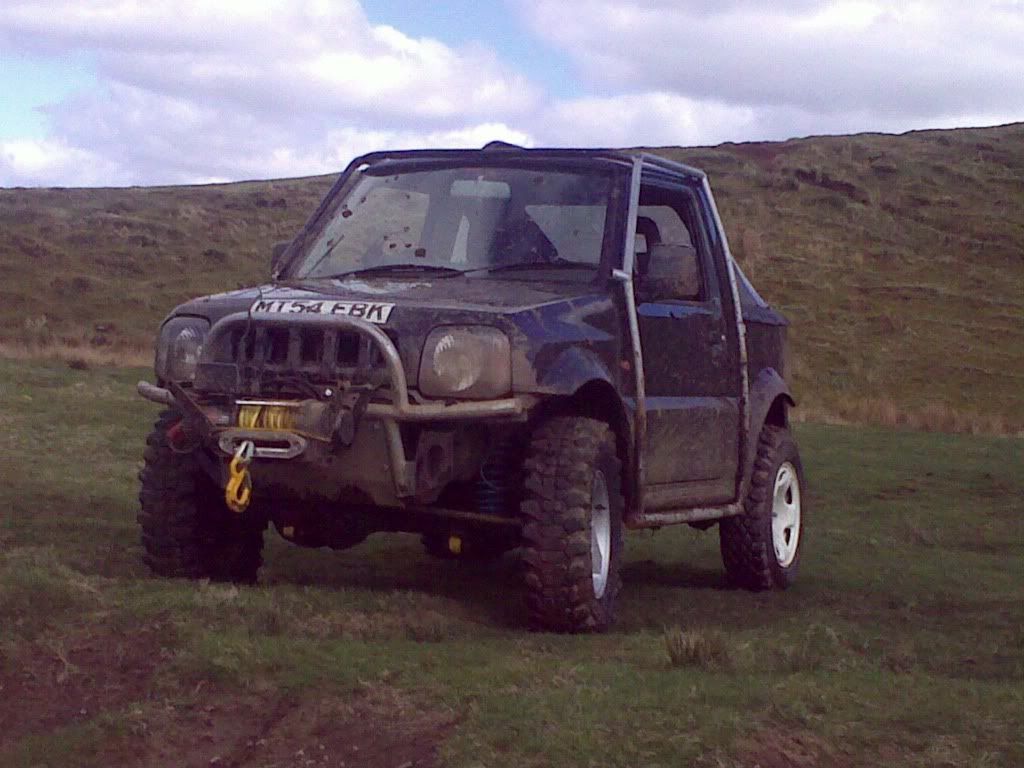

I've got a detachable winch ,which sits in its cradle with 2 handles
It slides into a reciever with a locking pin and connects to a Anderson plug
I have this set up on the back aswell so if I'm stuck and can't go forward it takes 2 minutes to change over to the back
I have the same setup on my sj and I'm about to do the same on my disco too .
Plus this way you don't have to carry all thar weight about when you don't need too ie trials.every day use .

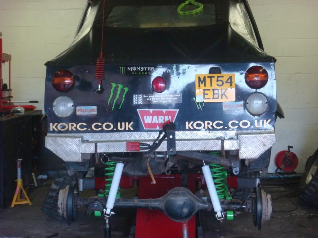

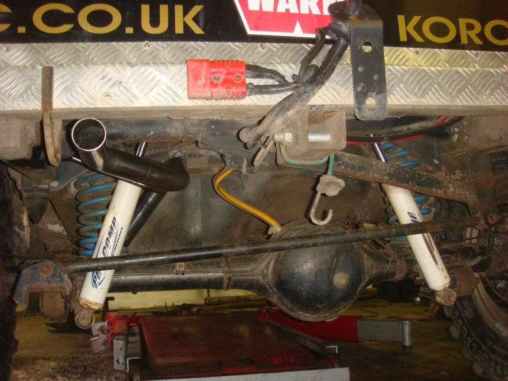

Rear set just like the front

I bought my cradle and winch together ,I think most of the big winch boys do them if not i can pm where I got mine from .
As for the wiring I bougt a big length about 7 years at the time cost me about 150 squid .i would hate to think how much it cost now, did 3 cars with that and have enough do do 2 more.
I know it will cost a little bit more to do this setup but I like it and its served me well .
