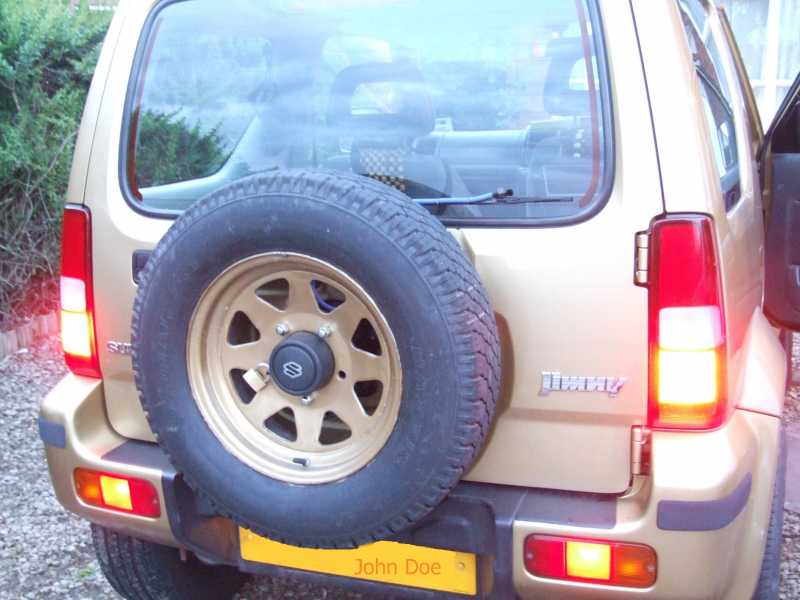

I've made a start as I found a Vitara bulb holder that would do the trick. I cut a round hole to size using a red hot piece of sized tubing. Then I cut out (only) two recesses for the bayonets to go through. There are more but why make it more complicated as two will do the trick, the others I chopped off the bulb fitting. I had to slim down the overall size of the holder body a tad and the wiring I'll do later.

09 Jun 2013 15:42 #73270 by darthloachie
Replied by darthloachie on topic Rear hazard/fog lights
neat job B)

All done.
