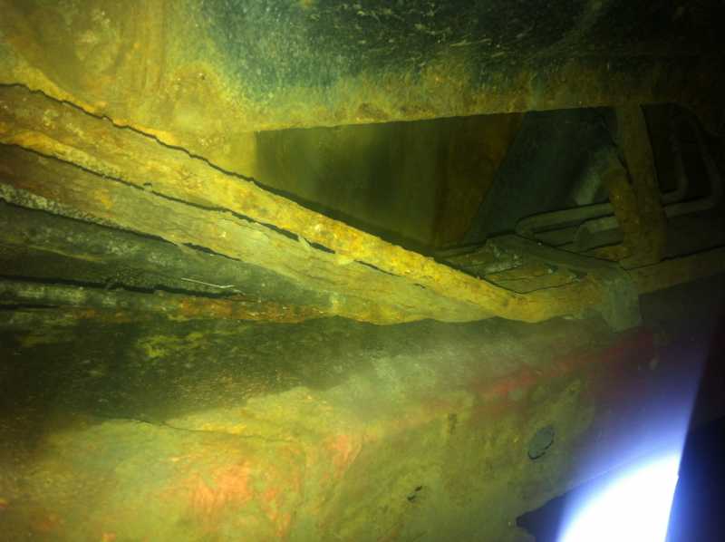

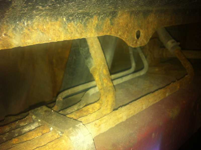

Hi people i have just bought my first Jimny and over the moon with it wanted one for ages but found that the 3 fuel pipes and 2 brake pipes are corroded at the back on drivers side just before they go up towards tank. Its only the last 30/40 cm can i join them all or do i need to replace the hole pipe? i HAVE ADDED A FEW PHOTOS IF YOU CAN MAKE OUT ANY OF THEM THANK YOU MARTIN

Joins add potential points of failure so avoid as you are dealing with brake and fuel lines. Especially brakes where its a highly pressurised system under braking.

Try cleaning up with fine sandpaper then painting

I disagree, looking at the photos, I suspect that touching them will make them leak.
Best to budget for replacement. This will cost a fair bit £150-£200 at a guess. This wants doing quickly, the brake pipes carry a lot of pressure, and the fuel pipes are both under pressure all the time the engine is running.
You can do them yourself if you are careful. You will need the pipes and a set of the plastic spacers/clips that hold them to the chassis- you will never get the old ones off so they can be reused.
Take a look at the front end of the pipe, where it curves up at the chassis rail under the drivers feet. You will see the same corrosion.
I'd get the pipes on the axle changed at the same time if they look rusty, it won't cost much extra.
Sorry to be the bearer of bad news, but you will only worry all the time you drive it that they will burst.
If it came from a trader, try taking it back and see if they will change them.
Mark is an MOT tester, I bet he would fail them

best getting them changed mine are exactly the same and ill be doing mine soon wayb to look at it is 1 lot of pipes keeps you on the road and the other keeps you out a ditch so without either yer buggered

My mechanical knowledge is very basic compared to most of the guys on here but I changed all my brake and fuel lines quite easily. Just get yourself a flaring tool (about £12) and you can do it. Be careful to get the right diameters, the fuel line comes in two sizes. The best advice I can give you is what I got from Façade and be very careful to note where each pipe connects at each end (best take photos and do drawing before hand).
