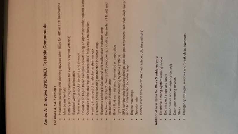

  • markyp2000
20 Mar 2013 19:16 #66403 by markyp2000
Replied by markyp2000 on topic New MOT checks
This is straight off my mot computor
  • RichiesJimny
20 Mar 2013 20:03 - 20 Mar 2013 20:04 #66409 by RichiesJimny
Replied by RichiesJimny on topic New MOT checks
Another crazy amendment is the shock absorber has a negligible damping effect is no longer a failure. We tested a Renault Laguna last week and the rear shocks where shot giving no damping effect at all. If we had tested this car today we would have had to pass it as there was no fluid leak from the shocks ( only because there was no fluid left in them ) so a car that was unroad worthy yesterday is now safe to drive because VOSA changed the rules. I'm sure the people at VOSA that wrote the test manual have never worked on a car.

  • markyp2000
20 Mar 2013 20:42 #66411 by markyp2000
RichiesJimny wrote: Another crazy amendment is the shock absorber has a negligible damping effect is no longer a failure. We tested a Renault Laguna last week and the rear shocks where shot giving no damping effect at all. If we had tested this car today we would have had to pass it as there was no fluid leak from the shocks ( only because there was no fluid left in them ) so a car that was unroad worthy yesterday is now safe to drive because VOSA changed the rules. I'm sure the people at VOSA that wrote the test manual have never worked on a car.
Reson for this is due to the damage to wings and bumpers etc from pushing down but if the fluid was leaking then you can fail it on that even if it has signs of leakage also advise it as dangerouse
  • Dave cc
20 Mar 2013 23:29 #66423 by Dave cc
Replied by Dave cc on topic New MOT checks
So if pushing down on a wing can negate damage what about poking around for rust with your MOT proder thing are you not causing damage ?????? and if rust falls on the floor and you dont return it whats it going to be next theft of part of a motor vehicle :laugh:
  • markyp2000
21 Mar 2013 07:59 #66435 by markyp2000
That tool is only ment to be used after you have used finger &thumb presure then your ment to tap corroded areas to see hpw far it goes and the other end is ment as a scraper on suspension conponents
