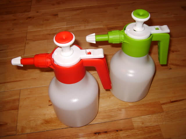

Why not just buy a big can & a pump sprayer?
