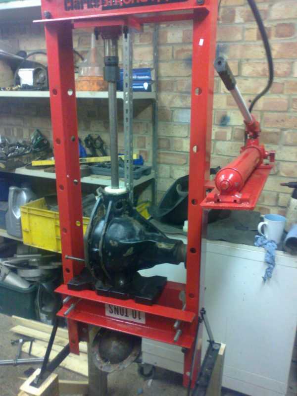

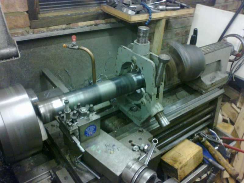

Here you go Tom after we milled out the welds we set it up on the press.
Maxed press out at Ten tons didnt shift so wound the saftey valve closed and prayed finaly cam apart at 13.5 tons
Other picture is we set 1 of them up on lathe had to turn dia back a little further on 1 of the axle shafts to allow it to go back in the other side
Fitted the jig heated it up and pressed it back together

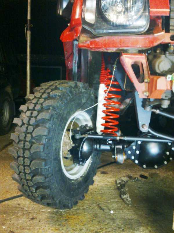

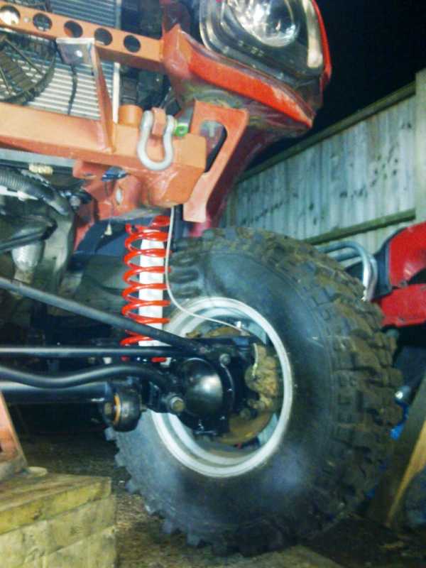

Full droop test for making up brake pipes

Sorry for my lack of knowledge Dave. But what did you press out of the diff with the press?
How did you get the axle tubes exact level before welding them on again? I'd think it would take some effort getting them 100% in line.
And those springs, they look insanely tall. is that a 4" lift?
But it all looks very impressive :-)

Dave cc wrote: Yes the axle tubes are pressed into the central diff caseing and plug welded to stop them coming out i machine out the welds and press them apart
I have a jig that then bolts to the case that stays in place whilst the cases are pressed and welded back into position giving a all but perfect alignment
Springs are KAP 4.5 lift they actually dislocate rom the top mount by about a inch on full droop
Sounds like an easy job then :P
I was just wondering, what is it you are pressing out with that long rod in the first pic with the hydraulic press?
