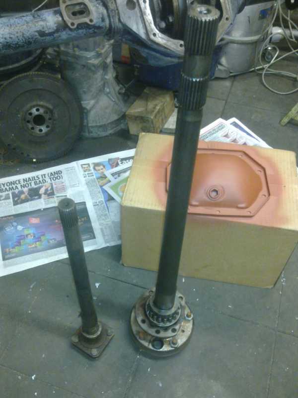

Had to post this picture to give a comparison G Wagon verse Suzuki rear halfshaft
