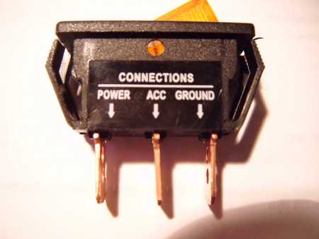

10 Feb 2013 13:19 - 10 Feb 2013 13:20 #61906 by dirtydogz
Replied by dirtydogz on topic Spotlights!
2002 JLX Soft Top B)
Jimnybits 2" lift +Pro Comp ES1000 shocks.:) Big Jimny rear shock mounts. Big Jimny adjustable panhard rods.
