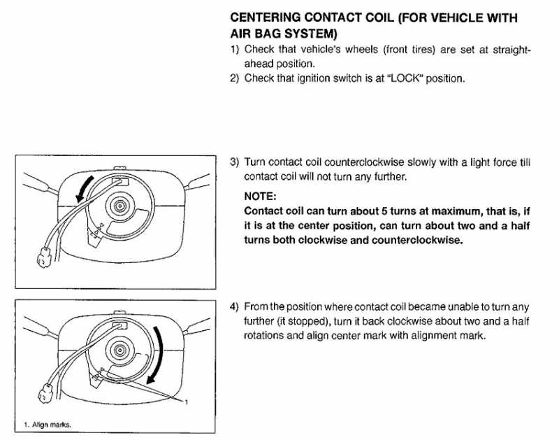

It isn't just children, likely I'd have spun the wheel to check the column bearings if I didn't know not to :dry:
Just in case you don't have a manual
