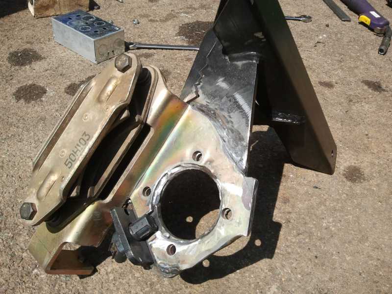

That's the fixing, now to the good bits: fitted my 6.5 gears and ORA HD mounts to the transfer box. This in itself was a bit chewy as the Xbrake kit sits exactly where the new ORA mount goes so I had to modify it with the help of my grinder and welder and space the xbrake disc to line everything back up again:
Success
Success
