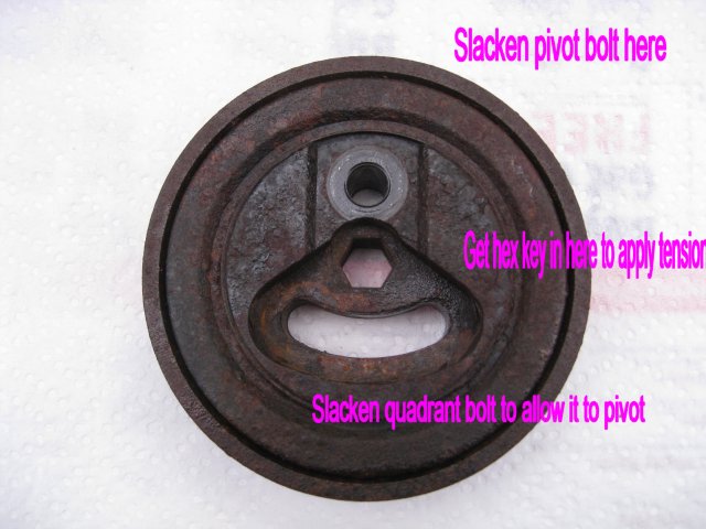

On my twin cam the power steering belt has to come off first: there is a pin inside a quadrant on the tensioner pulley that undoes and the pulley pivots. To get the tension back you need to fit a hex key into a hole in the adjuster and apply tension whilst tightening the bolt. (This is a minor miracle if you can do it)
To change the actual fan belt you need to undo the pivot bolt at the bottom of the alternator. If it wont come undone you will have to use huge tyre levers to force the alternator round, or spend a day taking out the radiator and stripping the engine to get the alternator brackets off the engine like I did
Here is the power steering tensioner on a twin cam, don't know what is on a single cam I'm afraid.
(If this is noisy like mine, a new one is £140 :woohoo: :woohoo: :woohoo: )

That Pivot bolt is the thing that is stopping me now, need to get this fixed before Friday. Really dont want to take the radiator out either.
Thanks for your reply.
