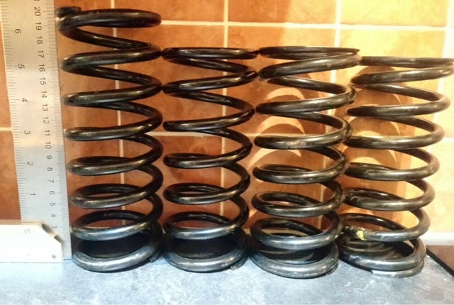

15 Apr 2022 14:04 - 15 Apr 2022 14:14 #242915
Replied by X8GGY on topic Dave’s long-term Lil’Bugga Buggy Build
Just browsing eBay, as you do, and some second-hand coilover springs popped up…
bid gone in

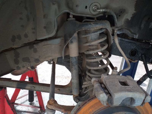

looking at stock suspension -
the cone with the bump stop on the bottom inside the spring looks to be 2”+3” long, and these are about 5.5” long, so should compress to 2” to 3” ?
(ones is 6.5” long but Mr.Angry will soon sort that
And they’re 2.25” internal diameter so will slip nicely over some 2” OD seamless tube roll cage off cuts I’ve got lying round, which will make the outer tube of the ‘pistons’ I’ve proposed above…
bid gone in

15 Apr 2022 14:49 - 16 Apr 2022 05:59 #242916
by gv42
Replied by gv42 on topic Dave’s long-term Lil’Bugga Buggy Build
I have got a set of stock springs off my 2013 jimny for sale
Last edit: 16 Apr 2022 05:59 by gv42.

15 Apr 2022 16:25 - 15 Apr 2022 16:30 #242917
[img][url]https://www.bigjimny.com/media/kunena/attachments/29464/0A1DABBC-2522-4CFA-8FA1-433A35FD9A3E.jpeg[/url][/img]
With some JimnyBits own-brand “Black Raptor” rear GeeVee shocks which are 29” open and 15” closed so 14” of articulation feasibly possible, but probably not in practice! LOL
Thanks Mark, but the above are the proposed helper springs to go above the standard new (4 fronts) Jimny springs I’ve already got ready -I have got a set of stock springs off my 2011 jimny for sale
Last edit: 15 Apr 2022 16:30 by X8GGY.
