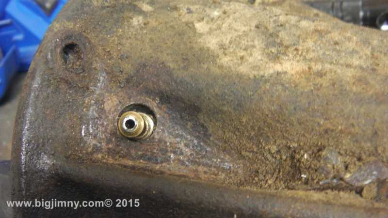

Or, the place 'we' buy fittings for breather kits sell bulkhead connectors?
24 Sep 2015 19:27 #152505
Replied by mlines on topic Re:My 2011 Rebuild
Hadn't thought of them, I think it needs to be 3/16 internal thread which may be a challenge
Sent from my Nexus 5 using Tapatalk

- X8GGY
24 Sep 2015 19:46 #152509
Isn't the thread irrelevant? As long as the nylon air line from the compressor fits in one side of the bulkhead connector (push fit connector?) and then the copper line from the diff / actuator fits into the other side, you can drill for any size connector through the diff housing? No?
Replied by X8GGY on topic Re:My 2011 Rebuild
mlines wrote: Hadn't thought of them, I think it needs to be 3/16 internal thread which may be a challenge
24 Sep 2015 19:53 #152510
Dave
The copper tube is terminated in a flare end with a 3/16 brake pipe style male fitting on the end. You can just see it in this picture I did not include in the article. Devon 4x4 do the replacement fittings but as the casing tapped thread also appears to be missing/non-existent I think it will not seal correctly which is why I am considering my options.
24 Sep 2015 20:20 #152511
Looking closely, it really looks like casing was never tapped. It looks like the fitting was installed with a hammer
