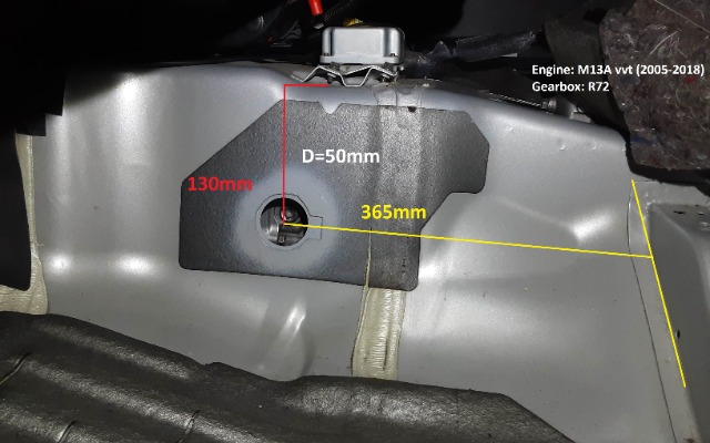

I'll create some template for that hole (I mean in the transmission tunnel
It will be something for drilling from the cabin rather than from tunnel obviously. I've already fitted the gearbox since my first comment. I'm thinking what could be used as a reference? I guess it will work for R72 type gearboxes only (2005 on)?
few hours alter...
Here we go!
few hours alter...
Here we go!

It would be good to know if this hole position also suits for the old R7ME gearbox or not. I guess from now on I'm sticked with R72 forever
