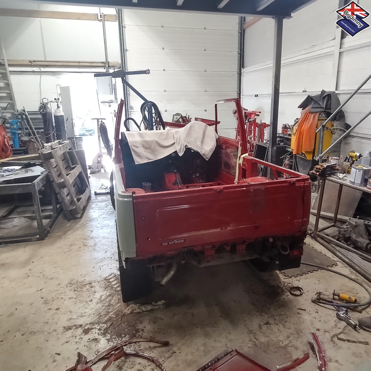

With the bolts in full retreat, Winchfield Engineering had a first look at the body panels.
Around the rear, with the wing panels and taligate removed, some more rust became visible.
This is behind the panel, so can be fixed with some fabrication rather than a replacement panel.
On the left you can see the end of the rear crossmember which will need some work to ensure the rust is completely removed
It looks worse than it is really, it should clean up fairly easily.

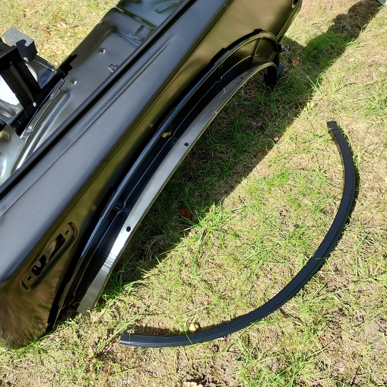

More dismantling!You may recall we bought new front wings and had to gamble on the Samurai wings (large wheel arch) being convertible to the SJ413 Wings (small wheel arch) and have the pressed in decorative curve line hidden under the large arch flange.
Therefore we wanted to check as early as we can in the process that the wing underneath the wide arches is, in fact, an SJ413 wing.
The picture on the left shows the wing with the wide arch (ie. a standard Samurai wing) and the additional narrow arch that I purchased.
The key difference between a Samurai wing and an SJ413 wing is the decorative pressing line around the arch which would be difficult to reproduce. However we believed that this pressing line is actually still there, hidden under the wider arch.
The spot welds were therefore drilled out on the arch.......
