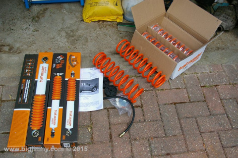

I have sold these kits through the store but never actually seen one. I was really surprised when it turned up as the "fitting components" box contained an extended rear brake hose and bump stop extensions which were not mentioned in the advert but are a valuable inclusion in the kit. The kit also comes with an installation guide so I am not going to go into the details here, after all it is just a matter of changing the shocks and springs!
Here are some "before" pictures...
First the kit itself...(Note: on this kit the boxes had the wrong spring labels on, however the springs were marked with their correct number)
