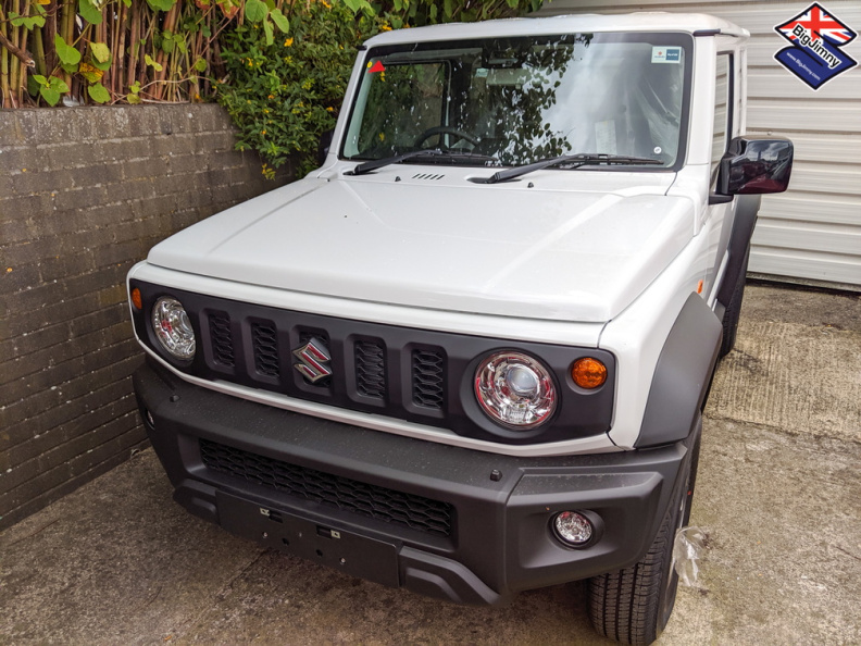

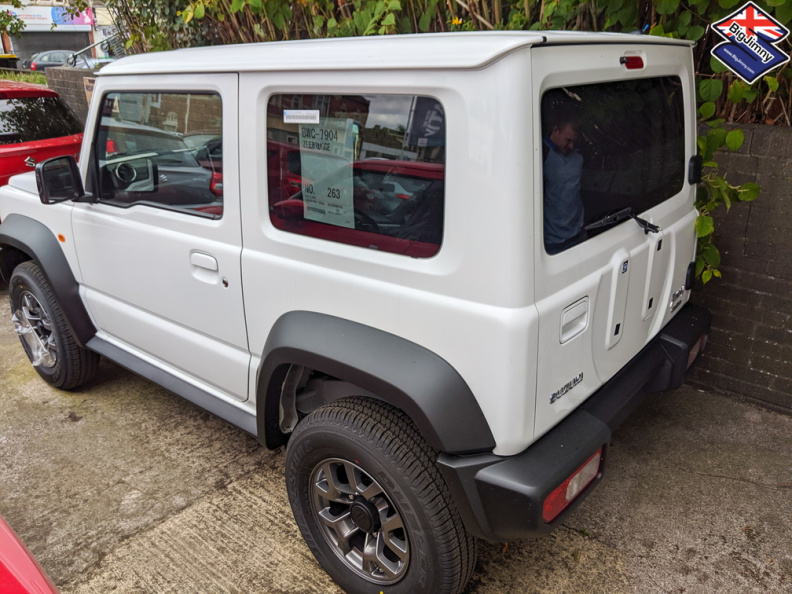

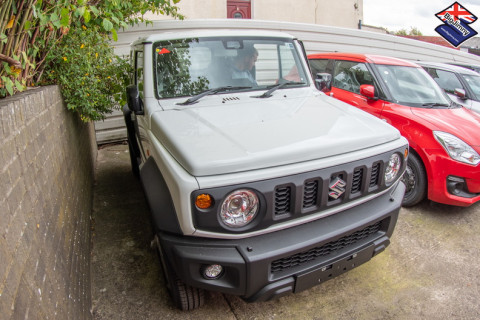

First of all a couple of pictures to show how "Gerald the Jimny" looked when he arrived at Roadworthy.
Each country has a different selection of colours available for the Jimny. In the UK we have a number of two-tone colours where the Jimny gets a black roof but we also have a couple of plain single (or solid) colours of which "Superior White" is one. Therefore Gerald was white, a lot of white.
This, in our opinion needed breaking up with areas of a different colour, indeed when we first test drove the new Jimny back in 2018 we said then that it needed a black roof.

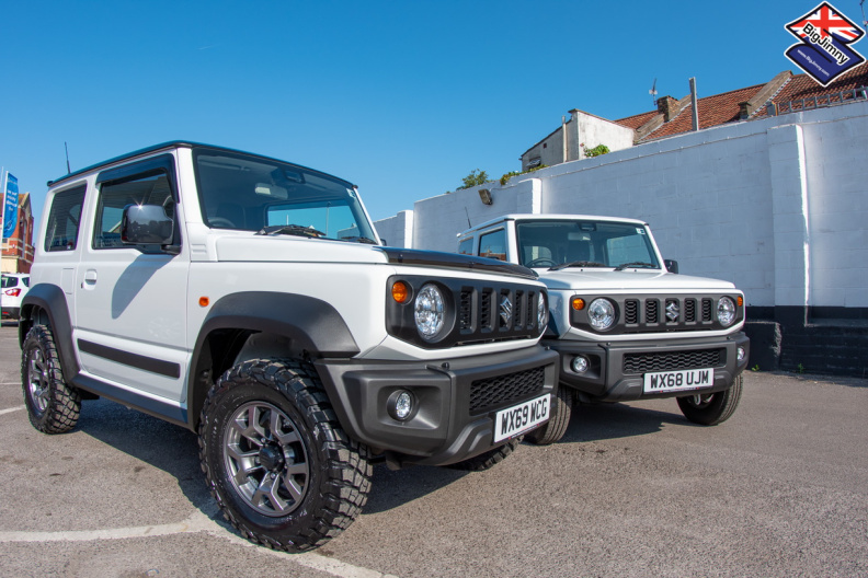

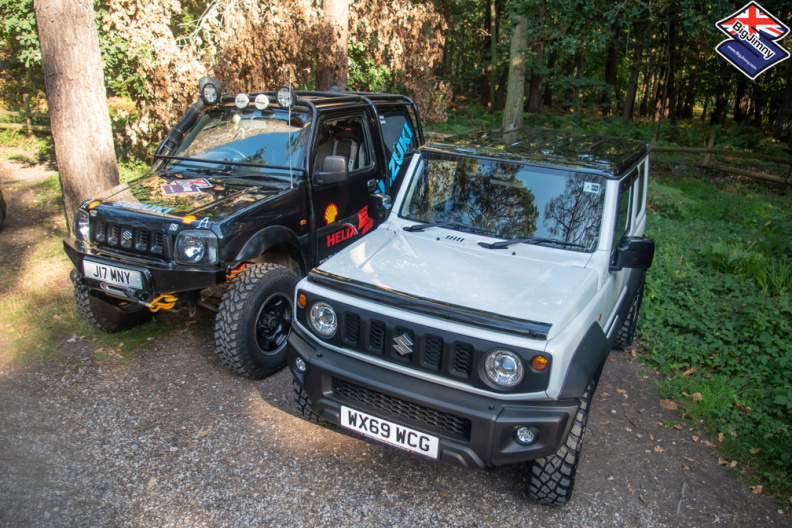

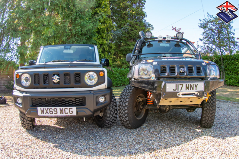

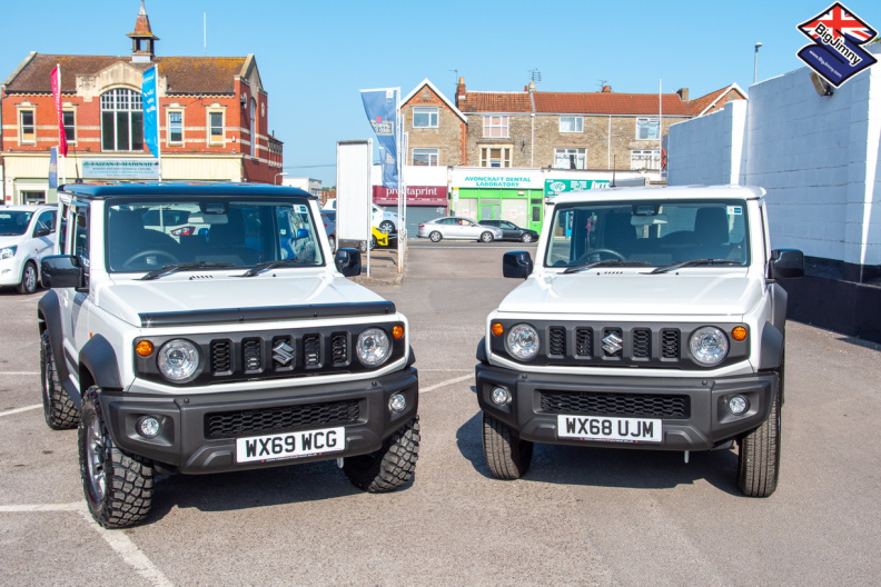

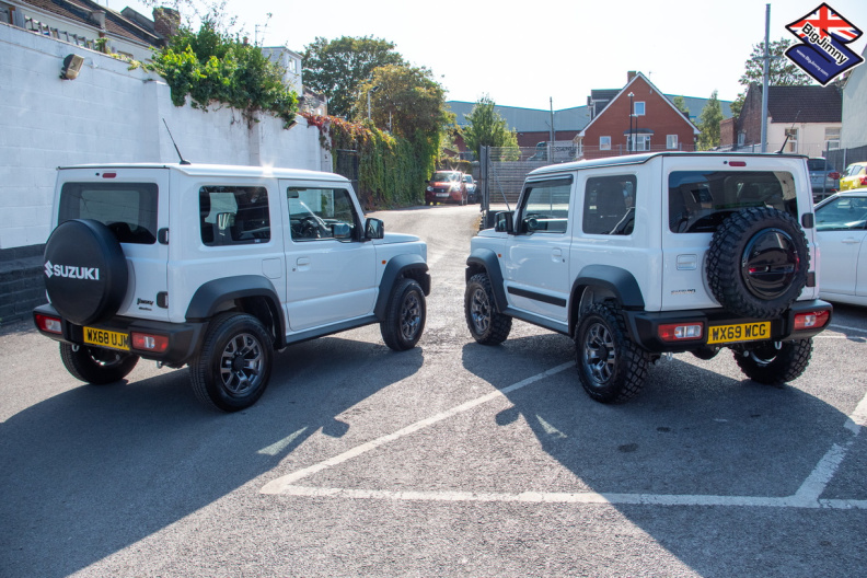

With everything done we collected Gerald from Bristol on the 21st September, all custom prepared for us by Roadworthy Suzuki. Here are some of the first pictures.
Gerald and a standard Jimny, side by side
