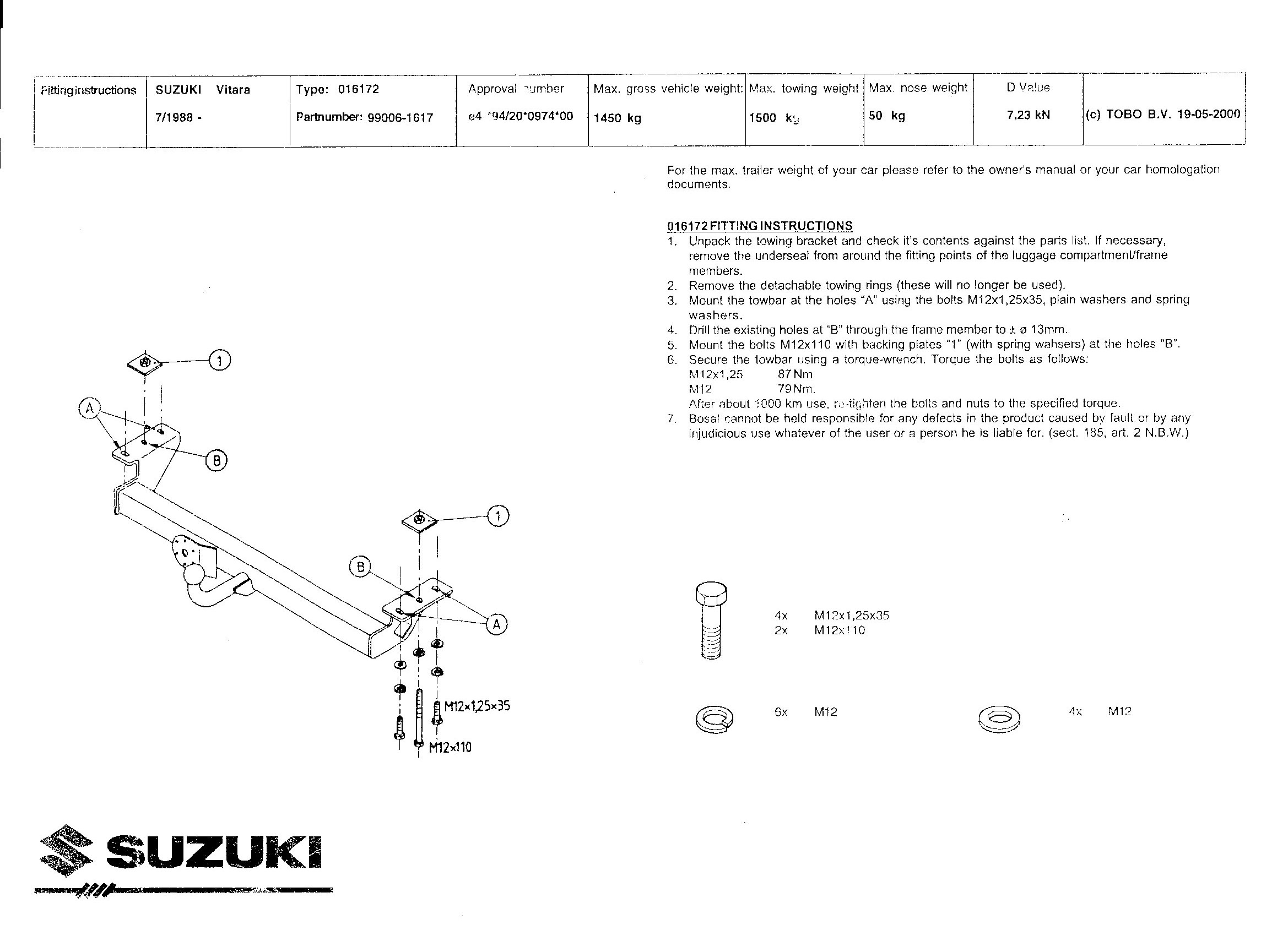

The SWB petrol models all use the same towbar. The genuine Suzuki aftermarket towbar had two additional long bolts that went up through the chassis and gave a much stronger mounting, the Suzuki electrics kit for it was also plug in so no butchery with Scotch-Loks.
17 Sep 2015 20:15 - 17 Sep 2015 20:20 #152144
by Rhinoman
Replied by Rhinoman on topic 4U general purpose tow bar help please
The Suzuki towbar was made by Bosal (016-172), I'm sure that it could be sourced cheaper. The tow rating on the towbars without the extra bolts is much lower.

"The Suzuki towbar was made by Bosal (016-172), I'm sure that it could be sourced cheaper. The tow rating on the towbars without the extra bolts is much lower."
This was exactly the sort of guidance I was after.
I'll have a search around for a Bosal unit and those extra bolts with the Suzuki plug in electrics kit.
The fitting instructions are also much appreciated.
