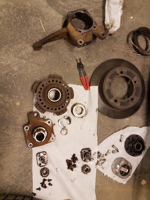

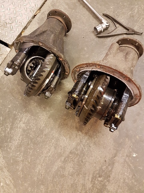

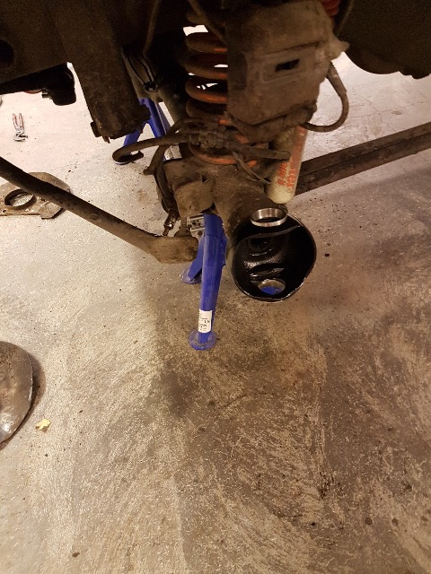

26 Nov 2018 13:45 #198176 by OlaGB

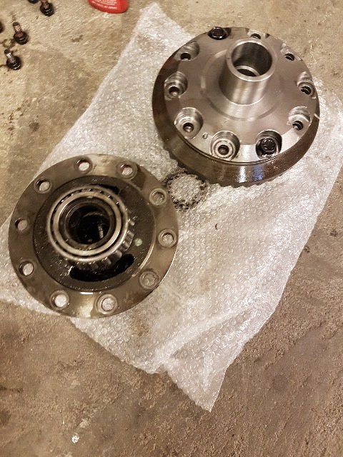

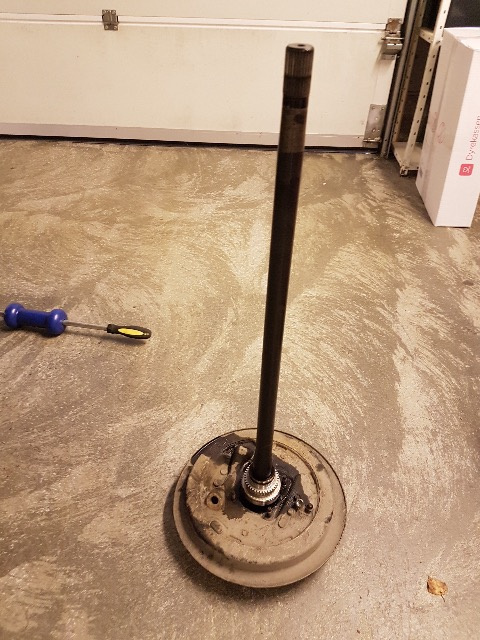

Ongoing, 2x air lockers, 4x HD shafts and wheel bearings. Everything at once..
Alot of work, but fun since ive never done differensial work before!

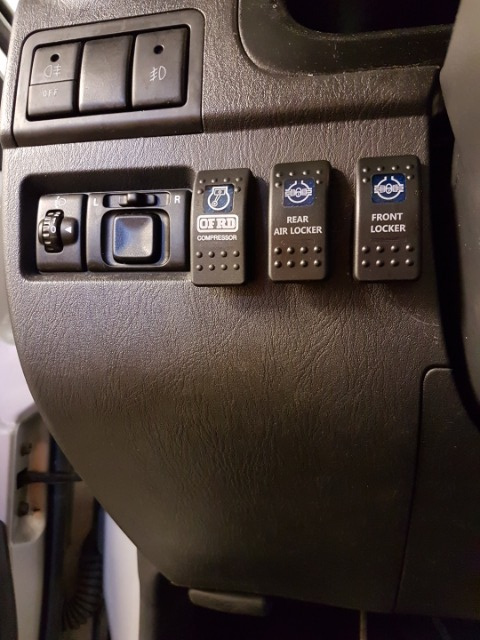

27 Nov 2018 13:15 #198228 by OlaGB
Riccy wrote: Air lockers are fun! watch as you get anywhere at the flick of a switch :laugh:
Yup, had it in a 37" Land cruiser 120 arctic truck before, but the car was way to expensive to do real offroading in.. I think this will be alot more fun to play with!

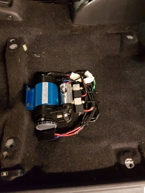

Gonna get help from a buddy tonight, installing bearings all over, so no diff install before tomorrow..
Got in the compressor today, and all wiring/switches.. Only left to do tubing to diffs..
