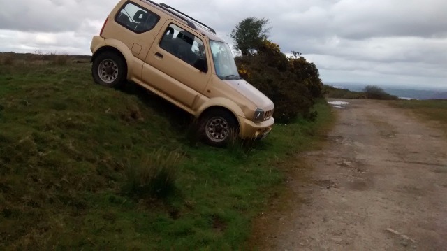

Here's a picture from far enough away that the state of the paintwork won't annoy anyone...
