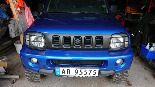

10 Oct 2018 07:13 #196620
Got a ding on the front of my hood. Stupid driving. So got most of it out again, put on filler, sanded, primed, and sprayed it satin black. Looks better than a dent.

10 Oct 2018 07:39 #196625
by OlaGB
Replied by OlaGB on topic The Jimny of the Yakuza
I think we need acouple more pics of that front , from different angles
Nice fix!
Nice fix!
10 Oct 2018 08:17 - 10 Oct 2018 08:17 #196627
That will only reveal what a poor job this was
But I'll post some later..
New regulations for lights now so I'll probably buy 3 or 4 7" lamps to put there..
