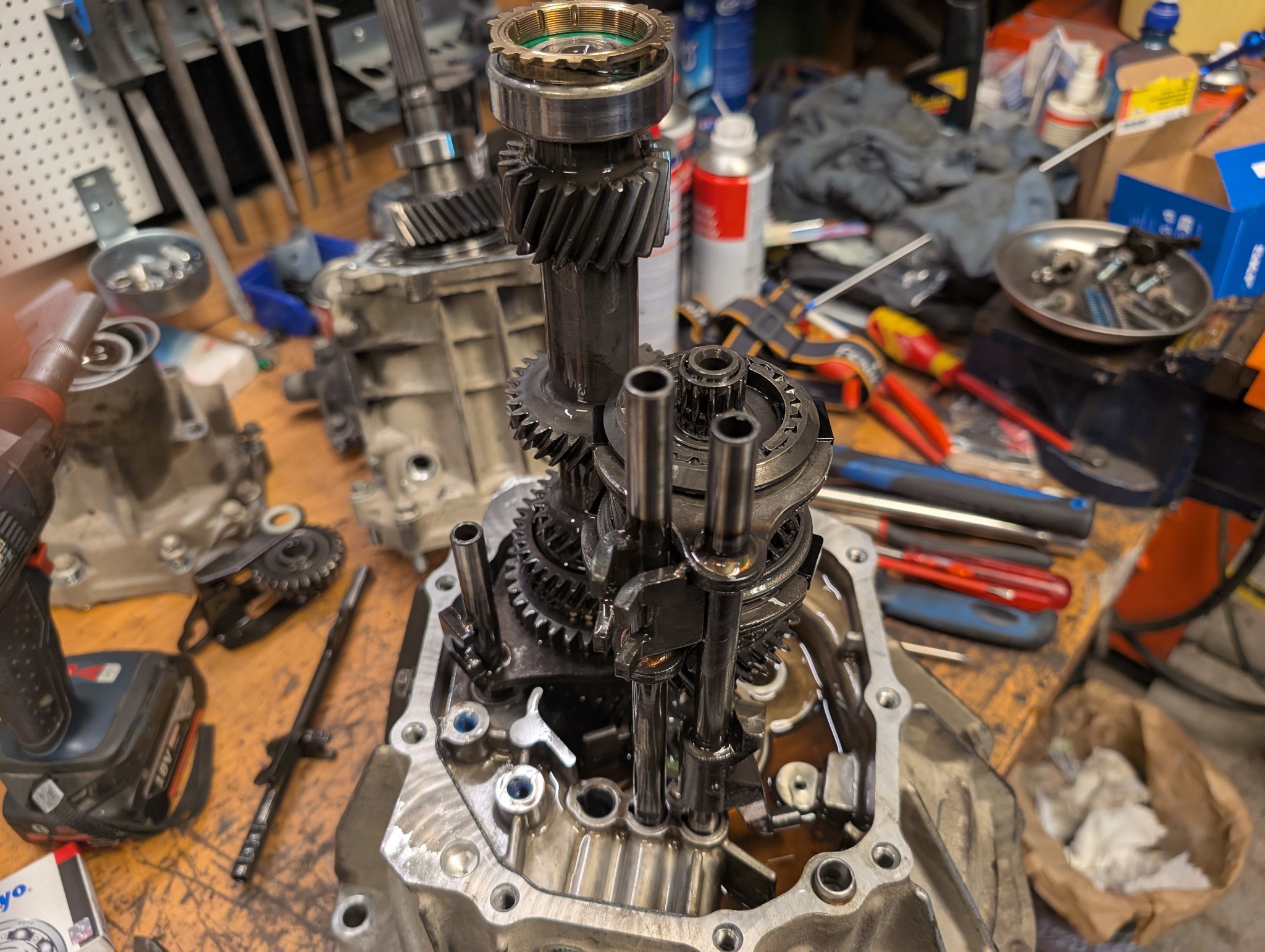

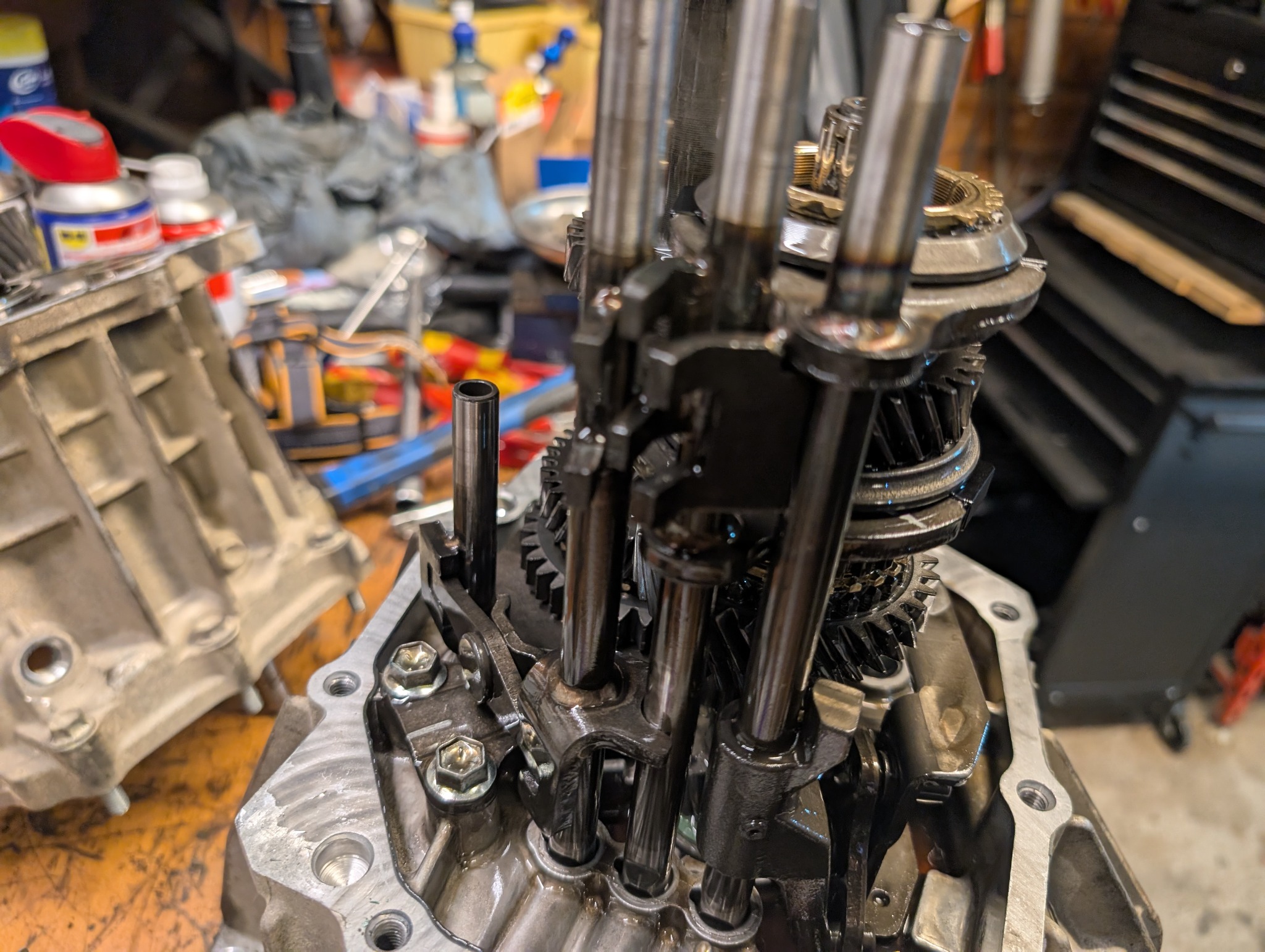

Been very nice weather here lately and as I have other cars I havent been speeding to do this job.
So got the box out on Friday, finally, after struggling with two bolts some stupid norwegian apparently had over tightened last year.
Got the case up on the table and it got it fairly easily opened.
Got the three shaft parts out and checked the recieved bearings for fitment.
Four of them in the kit with closed sides on them. only twoor three that I got out had that. This box is a 2010 or 2012.
all bearings in the kit was the right size and of a well known brand like NSK/Koyo.
So last night I was down in the workshop at work on the calm sunday to borrow the press.
all worn bearings went out, and the new ones went in easily. Only hassle was finding small enough tools for my tiny gearbox in the large shop.
All five ball bearings had noticable play in them. But nothing alarming. Glad I cought it early enough so I could save the box.
nothing else in there had any issues as far as I could see.
got the box almost back together last night, no problems except the three fiddly synchro ring bits.
But had to stop when I saw a snap ring left in the parts magnetic bowl.
I can remember taking it off as it was a bit fiddly, but not where it was in/on the box..
it is an approx 20mm snap ring seeger type with the eyes, not the circlip C-type that was on the gear shafts.
Been looking at my pictures, reading manuals, watching videos of dismantling R72's on youtube..
But I cannot find where it should be and I am going slightly mad over this
Edit: Maybe the input shaft, there is a groove there amd the other grooves all have rings allready. Cant wait to get home to see if it fits now.

Found another groove and then I rembered that was where to put the snap ring. Got the box all together nicely, and the box up under the car. Tightening bolts and Brackets, exhaust and driveshafts tomorrow. Then the other wheel bearing I left off earlier, while the car is off the ground.
