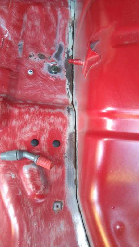

10 Oct 2016 16:14 #173323
and outer arches
inner sills
must admit the rust on this jim is minimal
but prevention rather than cure
Jack

11 Oct 2016 17:21 #173380
Replied by jackonlyjack on topic Red & Black Basher
dugout all the old seam seal before painting
also on inner sills removed factory underseal
just be aware half the rust on sill was not visible it creeps behind
the underseal :ohmy:
Jack
Jack
