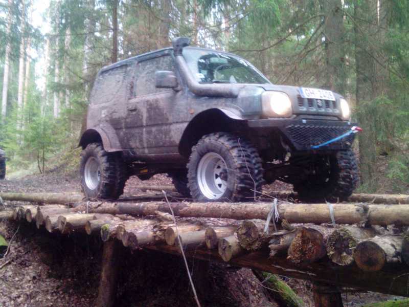

19 Apr 2015 11:53 #142757 by vdl
Replied by vdl on topic green turtle
after months of unsuccessful attempts to legalize build i'm going to get sports passport for my turtle.
almost finished - yesterday was first real test
same place again - from front
  • vdl
19 Apr 2015 11:59 - 19 Apr 2015 12:00 #142758 by vdl
4xfourart lift had really short shocks for those springs - replaced front shocks with longer ( also softer - not by choice ) - KAYABA 343282 - bushing needs to be replaced to use it on jimny - took from 4xfourart shocks
could not find quick replacement for rear shocks - so they got homemade spacers - 7cm
