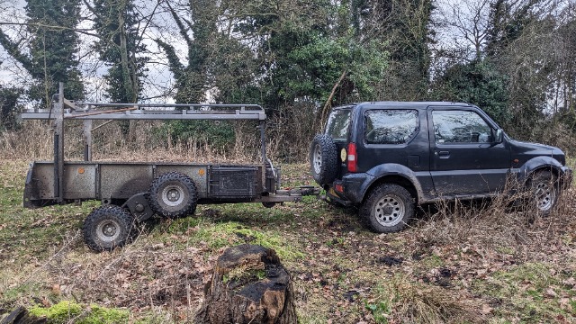

Busta wrote: This is my current Jimny Forwarder setup for around the marshes. It's an area of very soft and bottomless peat bog, so not breaking through the top layer of turf is the name of the game!
I've made some low ground pressure rocking beam bogies that bolt to the hubs of my single axle trailer. With up to 800kg of wood in the trailer it travels as lightly as the Jimny. Jimny and trailer tyres are all at 10psi. Jimny in 4wd with Quaife LSD and welded front diff. Breaking traction is avoided at all costs!
I know it doesn't look like much of an off-road situation but, for context, we don't take our unloaded Defender on 32" tyres around here in the winter because it's too heavy and makes a mess!
Love the trailer. Articulation of wheels awesome.
What suspention you using

18 Jan 2023 08:53 #246984 by Busta
Replied by Busta on topic Re:Lumberjack Jimny
The Jimny is on new standard height front springs, front and rear. I had been running it without the anti roll bar for better articulation, but with the welded front diff I've now got traction even with wheels in the air so I've re-fitted the anti roll bar for better handling at speed on the road.

I have long held the belief that electrically powered trailer/caravan hubs would be a boon in situations that members like Busta or Lambert face in their daily jobs of driving on soft/boggy ground. Yes there would be problems related to control but the distances involved need only be short so control need not be that sophisticated. Has anyone ever come up with a solution?
Roger
18 Jan 2023 13:10 #246989 by Busta
Plenty of hydraulic drive trailers exist for forestry. You can get bolt-on 'mover' units for caravans, but I wouldn't fancy their chances of survival in a farm environment.  www.witter-towbars.co.uk/caravan-movers/...ro-auto-engage-mover
