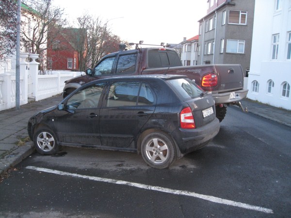

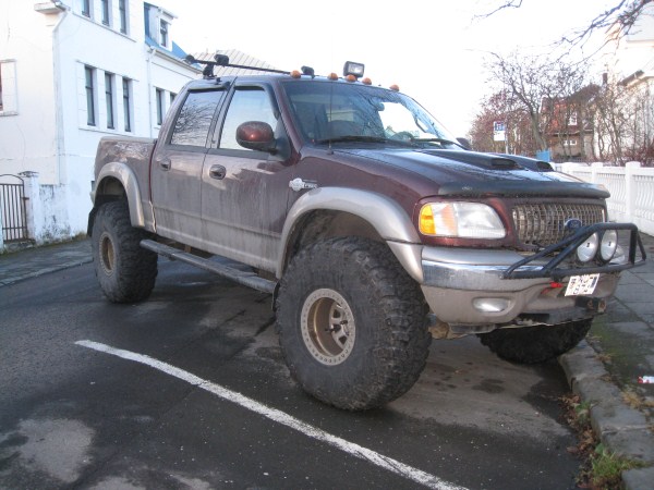

maverick wrote: I went to work in Rekjavik 2yrs ago in December - I just couldn't believe HOW BIG they modify their 4x4's out there!!
I wanted to go back last February for my honeymoon, but wifey said she wanted to go to Luxor instead :(
I must get back to Iceland :)
I got a load of holiday snaps of insane 4x4's from my times in Iceland. Would love to take the J and go "White-laneing" :D
