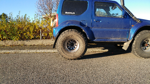

- HolmarH
20 Sep 2017 16:14 - 20 Sep 2017 16:15 #184276
by HolmarH
Replied by HolmarH on topic Holmar's Jimny from Iceland
Last edit: 20 Sep 2017 16:15 by HolmarH.

how do you find the lsd in the yota axle?thinking of getting a v6 but unsure about the lockers, currently got an arb front and rear in jimny axles, thinking that despite the increase in power it may be worse in a way with the v6 and an lsd rear. Wondering if better to get an arby's for the rear yota axle or leave the lad rear and get a front arb, what you reckon?
- OllieNZ
24 Sep 2017 08:45 #184417
by OllieNZ
Replied by OllieNZ on topic Re:RE: Holmar's Jimny from Iceland
The lj 78 has a factory installed lsd. You can also get factory e-lockers, the front axle diff of the 80 series is the correct size for lj70-78/hilux axles. They are also found in some hilux rears but are quite rare.rexthecat wrote: how do you find the lsd in the yota axle?thinking of getting a v6 but unsure about the lockers, currently got an arb front and rear in jimny axles, thinking that despite the increase in power it may be worse in a way with the v6 and an lsd rear. Wondering if better to get an arby's for the rear yota axle or leave the lad rear and get a front arb, what you reckon?
- HolmarH
24 Sep 2017 11:34 #184421
by HolmarH
I dont like the lsd. It always fails when you needed the most
I put lsd in because I had no others lockers at the moment. But in front I mounted some shims in the lsd and it works alot better than the rear.
I am going to put air lockers havent had time to do that yet, the time will come.
My friend has g13bb original axles air lockers and 35" tyres no problems at all. It all depends how you drive.
Another I know has 38" g13bb and original axles. He uses it but I dont know about problems there.
The yota axles are about 100kg heavier than the original, and I felt a lot of difference in steep side hills when driving. This extra weight is under the chassis so the stabililty got better.
The main reson why i put yota axles was because I wanted some lockers. But I like to give it some gas so the extra strength in the axles is good
