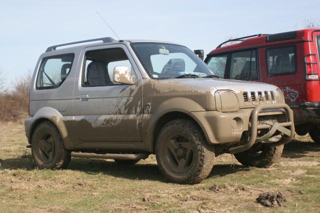

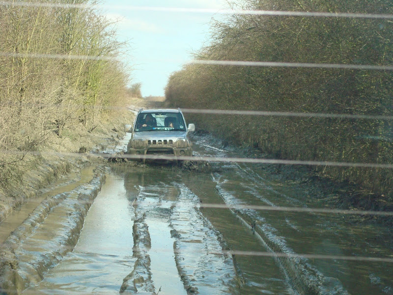

Well I've been loitering on this site for a while now, so time to say hello.
Standard Jimny with 195 KingPin All Terrains, belongs to the wife in the week, and is mine to play with at the weekends.
Video here
This weekend the ground was nice and soft, but I think I need to be looking for some underbody protection.

Crickey, looks like you had fun!!! You did well getting through that with just All Terrains on, be careful with ruts as the radius arms ground out in the middle of them, as I found out to my cost on a standard Jimny once!!!
Also, I think you've only used the A bar to wrap your tow strap round to store it, don't for heavens sake use it to tow from though.

The A bar, as you say, is just for show. I've removed the centre trim bit from the bumper and exposed the ends of the chassis rails, into which I've hung a couple of shackles.
