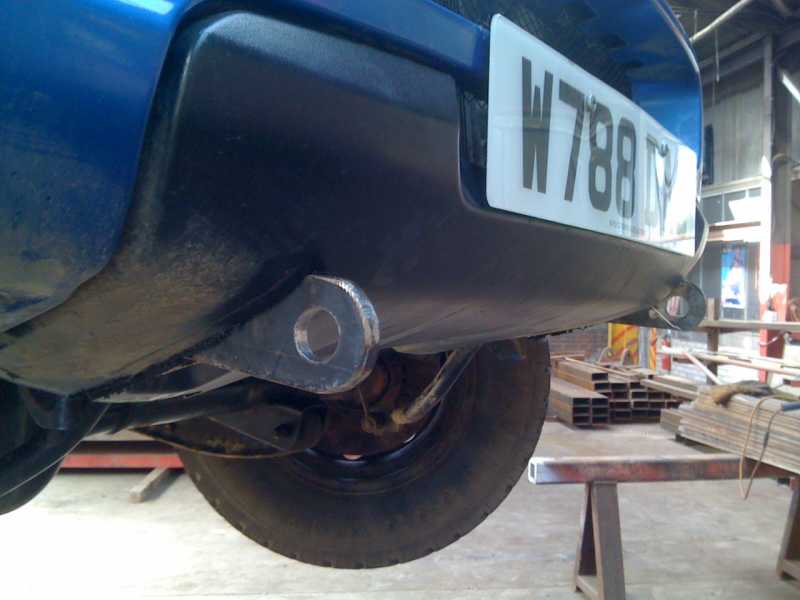

- Back in Black

Hey Myers647 - how/where do they mount at the front?? Sound interesting. I've got a tow bar for the rear (in the garage), so interested in the front. I loop the straps around the chassis ends at the moment.
