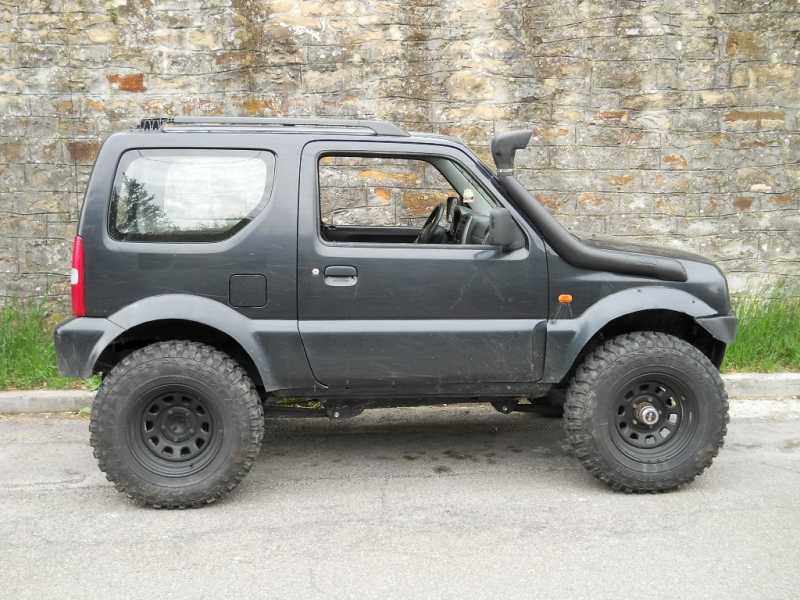

Had some "problems" with cops (which station is about 100m from my home) ... no fine but they summon me to lower my jimny ... so ...
i kept the 1" bodylift, then i replaced the marvellous 5" lift kit with stock spring plus 1,25" spring spacers, +2" shock absorbers, stock arms, panhards, etc ...
now my jimny appears like this:
just tested it this morning in a small offroad excursion ... i needed to beat the wheel arches with an hammer, but everything now fits ... first impressions are: worst articulation and better lateral stability ...
