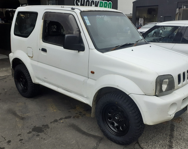

by KiwiZook
Replied by KiwiZook on topic New Wheels on Old Jimny
Got a set of Gen4 wheels and tyres cheap without doing any research - doh.
Didn't fit my Gen3, tyre diameter and offset way too much and they impinged on the guards.
I ended up taking my original Gen3 wheels and getting them dip-stripped, rust protected and powder-coated black - ended up cheaper than a new set of steel off-road wheels.
Tyre wise - I found the original Suzuki Gen3 tyres hard to find and VERY expensive for what they were (you could buy 32's or 33's for a Hilux cheaper).
Ended up finding a much cheaper mud-tyre from a local supplier that was almost the same dimensions as the orginal Suzuki spec tyres but about half the price - just because they were more common.
Was happy with the result.
[attachment=45433]Bazooka01.png[/attachtment]
Then the wheels were not stock Suzuki wheels. I have transferred the same wheels and tyres from an SJ to a Gen 3 and then to the Gen 4. They were 215/80R15 tyres and the only issue was slight rubbing on the wheel arch liner on the Gen 3.
