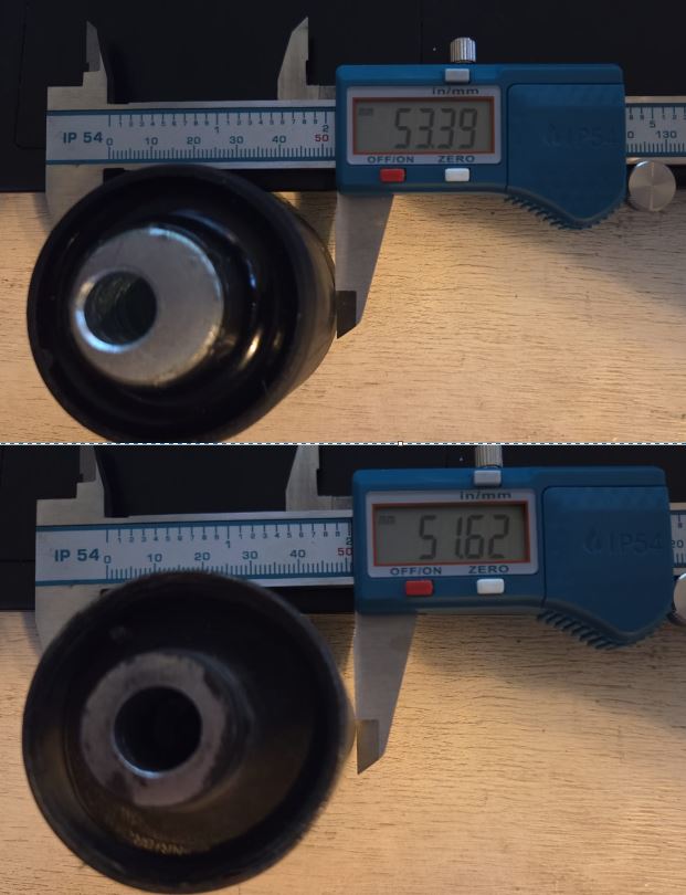

27 May 2026 17:21 #264534
by fordem
I ran into this situation over the weekend ...
One end of the OME bush has a taper, how we dealt with it was to increase the taper so the bush would enter the hole in the arm and then press them into place.
Replied by fordem on topic Bushing install?
Need some advice on OME 40mm lift kit install.
The new bushings for the control arm are 1.6mm larger than the ID in the control arm. (It's normal for the new bushings to be about 1mm larger than the ID to compensate for worn ID on the control arms.) Instead of deburring the control arm ID by .5mm. As spelled out in the instructions. The machine shop wants to reduce the OD on the bushing by .8mm. So the bushing will be .8mm larger than the ID on the control arm. But still fit. And stay in.
The instructions say to deburr the ID on the control arm by .5mm. Is this a problem?
Their excuse is that reducing the control arm ID will make the control arm unsafe. That it will make the walls around the bushing to thin. And they will get blamed if it breaks.
I'm in the Phillipines. I know this sounds like a sh*t show. But it's what I'm dealing with. The mechanic has the lift kit half installed. And I'm running control arms back and forth to the local machine shop.
I checked with the mechanic who is installing the lift and he agrees that reducing the OD on the bushings is fine.
Advice?
