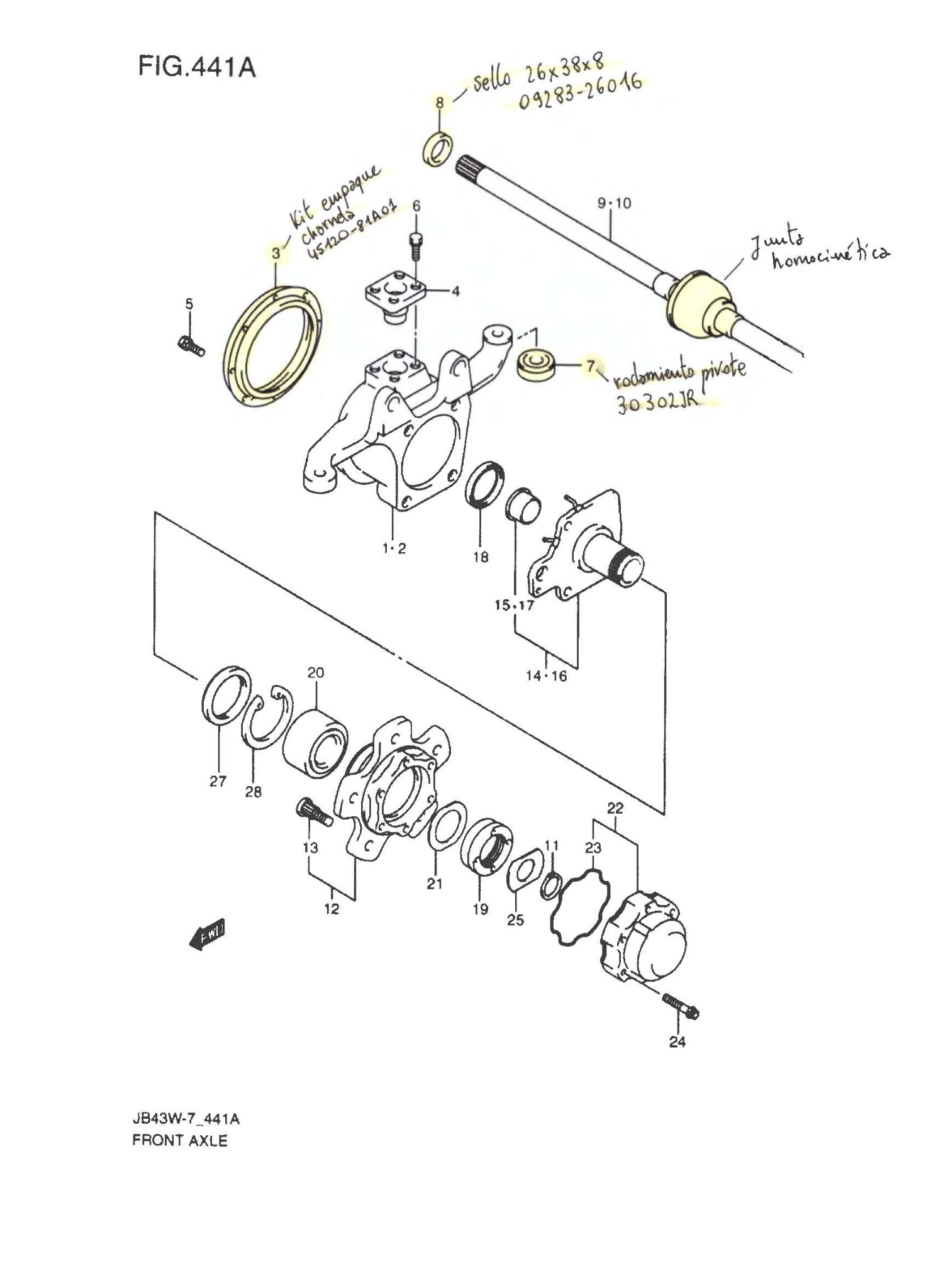

End of this week or next week I should receive CV joints from Febest, they are the only I can get here, from Amazon US... And then I will post the pictures. Anything else I should possibly replace while unmounting the front axle?

other parts to inspect and possibly service would be the shaft seal and hub seals and possibly the king pin bearings and swivel seals.
These parts can be bought as a kit.
I would change the shaft seal inside the axle everytime i was in there as it is cheap and the consequence of it leaking is way more expensive when/if the oil wash out the grease in the hub.

Replied by jackonlyjack on topic Visual diagnosis of a worn CV joint
+1 on the shaft seal
Also have some 30302 bearings to hand if your kingpin bearings need to be changed........ You can always pop them on the spares shelf for another time

Thank you, I guess I will have to buy these three parts, which are thankfully available at my local dealer
Price for one side:
Kingpin bearing 30302JR (Koyo) $39,000 = US$9.36
Oil seal 26x38x8 $12,000 = US$2.88
Steering knuckle seal 45120-81A01 $30,000 = US$7.20
Price for one side:
