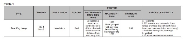

The third gen rear lights are in the bumper, the red upper light is a rear fog - before you change anything familiarize yourself with the lighting regulations where you happen to be - there may be a requirement for the rear fog to be more than a specific distance from the remainder of the rear lights.
I have done what you are asking about on a Grand Vitara, but I'm in a country that doesn't require a rear fog, and in fact the only rear light required by law is a single red light "affixed to the right of center"
This GV now has dual sets of tail lights, brake lights & turn signals, one set (two) number plate lights and one set (two) reverse lights.
A side effect of this modification is a blown turn signal bulb does not have the "fast flash" tell tale, which may also be a legal requirement in some jurisdictions (it's not where I am).

The text above is from one of the UK IVA standards - the rear fog has a minimum height requirement as well as a minimum from the brake lamp.
The regulations differ depending on country, I think Australia requires the tail lights to be visible from any angle behind the vehicle, tail gate mounted spare wheels cause a problem, so they also use the tail lights in the bumper, but as far as I know there is no requirement for a rear fog.
