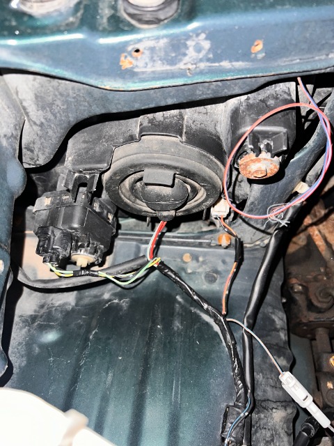

Before I start throwing new parts at this, thought I'd ask the group.
New to me 2003 JB33 Jimny
Spinning the headlight adjuster/rotary wheel 0-1-2-3-4 does not move the headlights. Is it simple as needing a new switch? Or both motors on the back of the headlights have died. I do not hear any mechanical noise from them when I spin the switch (standing outside the car with the bonnet up).
I pulled with switch out and opened it up. Not much to "clean" inside as far are corroded parts. Popped it back in, still nothing.
Is it possible the previous owner disengaged somewhere as it has a 40mm lift, maybe not wanting to dazzle drivers. Have tracked the wiring from the back of the switch... looks good. Same as back of both headlights... wiring all looks good.

Maybe get a test meter & verify power - all we can do from a distance is guess.
23 Sep 2024 11:20 #257655
Replied by Soeley on topic Headlight level adjust not working
Blown fuse?
23 Sep 2024 12:12 #257656
Replied by mlines on topic Headlight level adjust not working
The common fault is the motor in the headlamp has rusted solid

Understood, was really probing for any known solves or watch-outs.Maybe get a test meter & verify power - all we can do from a distance is guess.

Thank you... I'll pull one and see if I can open it up, have a look inside.The common fault is the motor in the headlamp has rusted solid
