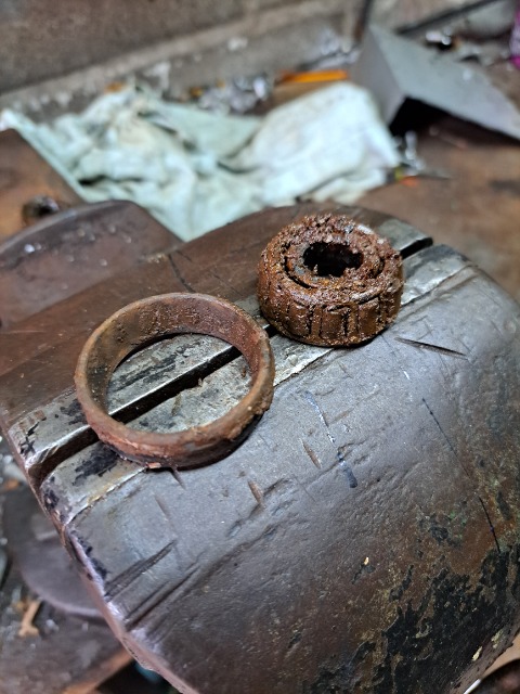

Decided to do the other side earlier, before reading the post, but I figured as it was the drivers side the shaft was a lot shorter so should hopefully be a lot easier to deal with which turned out to be true. This side didn't come apart anywhere near as easy as the passenger, had to resort to hammer & chisel to get the bottom kingpin out.
All cleaned up & back together now, just need to get 4 track rods so that they all can be done, then taking for tracking, before thinking of new tyres.
Both hubs have been welded so at least they were consistent, but on the lookout for a set to replace them with, not urgent as mileage is very low.

Just for clarification if it was missed both hubs have been welded, I have also found another set for £40 so once they arrive I'll check them over & install to see if they work, I would prefer them to be freewheeling & work on the vacuum.
Edit:- Just to add I had to go up the farm this morning & I can't believe how much difference it appears to have made, now it might be psychological as there didn't seem to be any play in the knackered bearings
