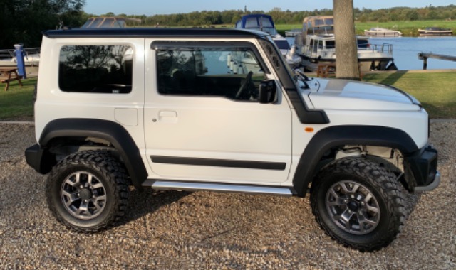

Replied by jlines on topic JB74 3 inch lift with 215/75r15 tires - looking for pics
I also saw this last weekend at the Jimny meet and from what I could gather it was running a 3inch lift and I would guess 31inch tires? I didn’t get to ask how it handled on the road. Also as you can see from the pics it no longer has the standard bumpers as I guess they don’t work at this level of mods.

21 Jun 2023 17:26 #249583
by Grizzlie
Replied by Grizzlie on topic JB74 3 inch lift with 215/75r15 tires - looking for pics
That front is hideously beautiful in a barbaric sort of way.
22 Jun 2023 06:47 #249589
by 300bhpton
Sadly I didn’t get see how it flexed off road. I did follow it for a while, but they stayed on the perimeter path.
Personally I wasn’t that keen on the no bumper looK and in the U.K. I’m not sure it is actually road legal and did present sharp (and rusty) edges.
Would be interesting to know what lift kit it was running. The front ARB angle didn’t look great, but it might still have good road manners??
As for the iOS question of tyre height. I’m really torn on this. I also don’t really want to regear. At least it isn’t a planned mod at the moment. But there is no denying Jimny’s in general are under tyred in stock from.

Replied by 300bhpton on topic JB74 3 inch lift with 215/75r15 tires - looking for pics
Think it had 245/75R16’s on. About 30.5”.I also saw this last weekend at the Jimny meet and from what I could gather it was running a 3inch lift and I would guess 31inch tires? I didn’t get to ask how it handled on the road. Also as you can see from the pics it no longer has the standard bumpers as I guess they don’t work at this level of mods.
