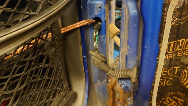

Rear door wiring loom connector? was created by yakuza
Fussy picture with all my extras, but trying to remove the rear door, but can not find a connector to unhook the wiring.
Is there any?
My rear door is full of sound deadening for the subwoofer so it is not so accessible in there.
Is there any?

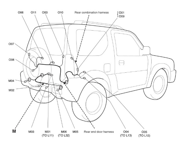

by facade
Replied by facade on topic Rear door wiring loom connector?
The rear door harness connects to the main harness deep inside the car, I have a vague idea it is down by the sill on the passenger side.
As it is completely inconceivable that the back door would ever need to be removed, or that the wires could break where they flex there is no need for a connector in an accessible place

15 Jun 2023 22:17 #249534
Replied by yakuza on topic Rear door wiring loom connector?
If you haven't filled your door insides with bitumen, and replaced the door card with a MDF speaker baffle, the wiring is easy access to unhook after flipping the door card out.
Fiddled the wires out from there finally.
Thanks Facade!
Thanks Facade!
