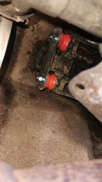

31 Dec 2022 11:30 #246599
Replied by jackonlyjack on topic Gear Box Woes
For anyone with hard to select gears on the R7ME box
it's these bushes that wear out
easily changed just undue the 2 bolts at top of the plate
remove and fit austin mini exhaust bobbins
then refit top 2 bolts
