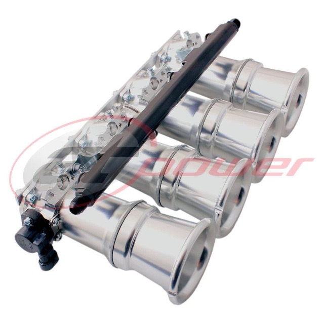

My understanding is that itb is individual throttle bodies as in one per cylinder on a custom set of risers to the inlet ports on the head. These are often recycled motorbike parts.

The set up from RZ Crew on my build thread is an injection plenum with a single 70mm throttle body.
ITB's (Individual Throttle Body) give a throttle body to each cylinder, so four on the M series.
I chose the plenum set up over the ITB's in an effort to find low down grunt, a plenum is better for early torque. ITB's are more an ultimate power set up and a fair bit more expensive.
You could get a plenum set up for an early VVT (55mm?) throttle body (cable) but you need to consider your end goal to avoid spending twice.... With the set up you mention, you could easily find the standard TB wanting. Then changing the inlet port on the plenum to suit a larger TB will cost, both money and time off the car. Be careful if you don't know much, its easy to mis-match parts and get poor results after spending a ton of cash.
Ah, my mistake.  I was thinking ITB as 'inlet throttle body' and using that to differentiate between that and the throttle body ( part with the butterfly valve that bolts onto the manifold).  Totally wrong, every day is a school day though.

Yes, the plenum setup would be better for me.  I totally misunderstood the acronym ITB.
It's the RZ manifold (AIR-S-ZC31NA) I was looking at getting as it is suitable for the 2009 engine.  It has a 60mm opening, so I thought I'll try and source something to fit that and make the most of the potential flow, that's the end goal, just maximise that and no more. Was your 70mm body an aftermarket part, or did you source it from a vehicle, or modify an existing one?  Also, on the RZ manifold, it has the TB mounting plate on the horizontal plane, did you have to get a 90 degree fitting to make the TB the correct orientation (upright?), or does that matter?
I wasn't sure about what I could fit to the RZ manifold because, of course, the bolt offset for fitting a TB may also restrict what will fit.  I would ask the guys at RZ, but they would probably give me information regarding swift sports and I may end up buying useless parts as you mentioned.
