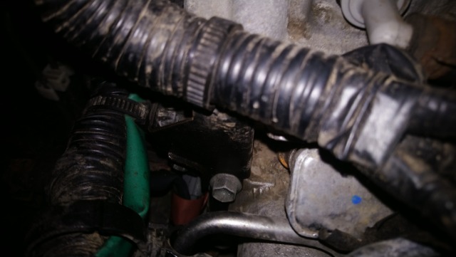

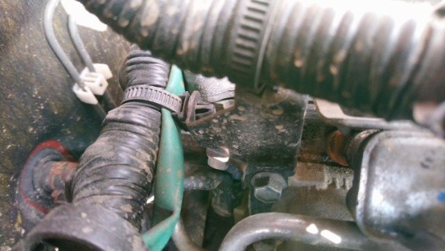

Replied by me101 on topic Cam sensor location on 2007?
Yep, 1 x 10mm nut. Bit of a git to get to.

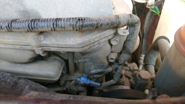

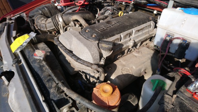

29 Mar 2022 10:08 #242546
by me101
2007 Little Jim with cheap mods!
www.youtube.com/channel/UCeBDekO99Qk2aOmBmSmrI9w
