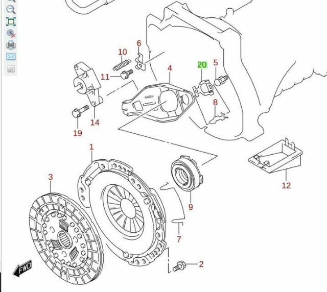

Me again. Had an hour in the garage after work, and have found the noise to be from the clutch fork. Taking off the plastic inspection cover, you can see the fork vibrating, and when I put pressure on it with my finger the noise stops. So, my new question is, how do I stop it rattling??

The most likely cause is the clutch release arm (4) is not fitted correctly to the bell housing pivot pin (5) or the release arm clip (20) is broken or missing. This allows the release bearing (9) to rest on the gearbox shaft and vibrate the arm. It's also possible the actual release bearing is not fitted correctly, it's also held by a clip (7). If you can see any of this through the arm gap in the bell housing you can eliminate each as a cause. If you can't it's time to split the box from the engine and take a look. You will be doing this anyway if the fault turns out to be a duff gearbox, but I don't think it is at the moment.
Here a similar diagram (Suzuki but not Jimny) to help identify the bits I am talking about.
ITS cheaper to check these parts first.
