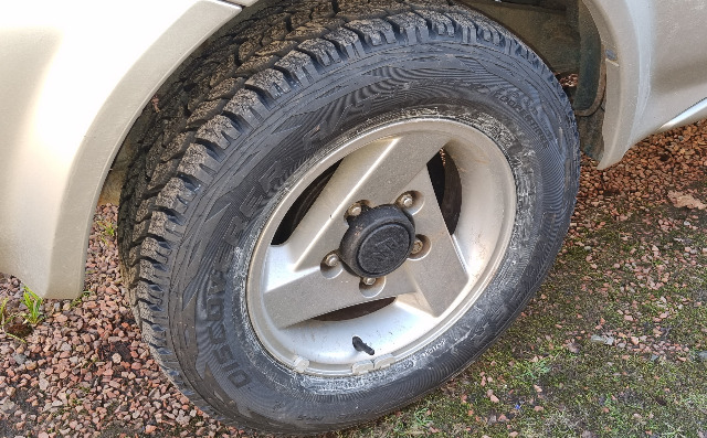

Glenfarg garage fitted the Cooper AT tyres, checked wheels and balanced, then fitted supplied new (BigJimny supplied ) kingpin bearings and swivel seals both to front sides and the wheel wobble is gone, John.
While it was there, we asked he change front and rear diff oil and gearbox oil. He confirmed it's really good and solid underneath just needs undersealing, another job for Lanoguard.
