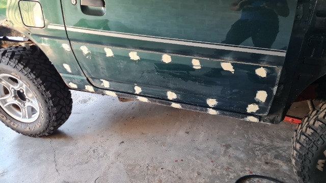

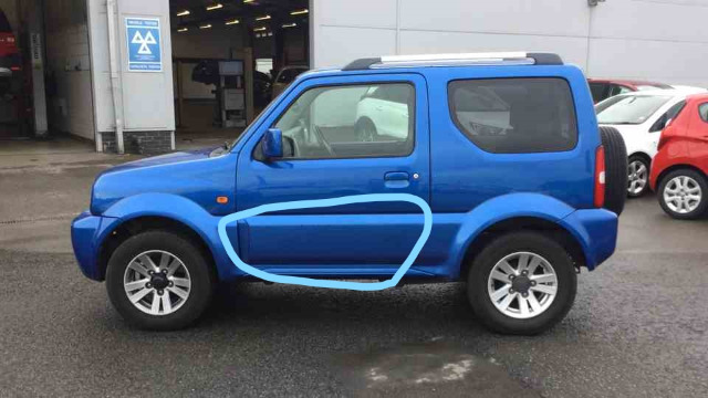

Hi,
I have some paint chips on the passenger side door, luckily they are in the plastic panel, but in a recent painting session, the colour match was poor. I have new paint on it's way, but of course the weather is no good now.
How easy is it to remove and refit one of the plastic door panels? Will I break all of the clips doing it? Should I just wait until next year for better weather?

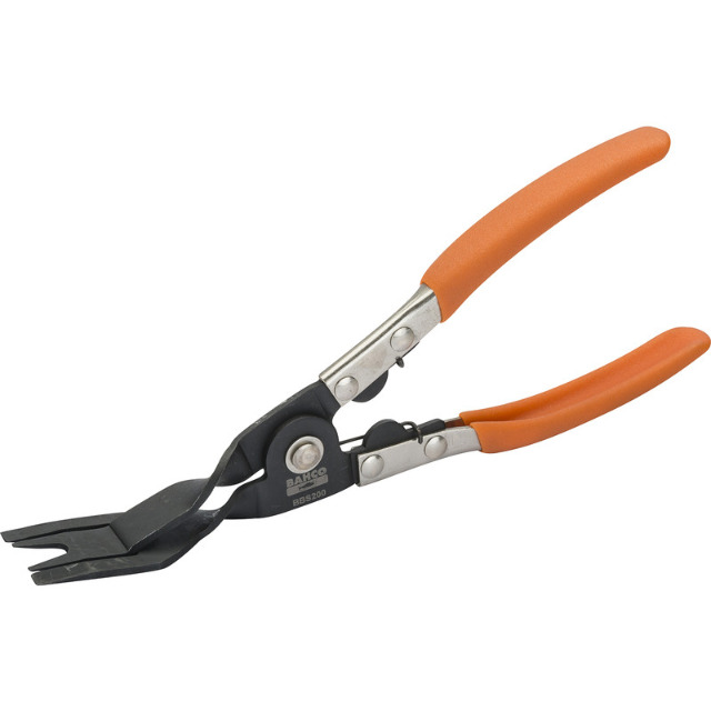

Depends on what you use for removing it. I have a pair of reverse action trim pliers and am usually quite successful. The plastic wedge type things I find more often than not kill clips but that could be operator error.

Is this what you use?
Do the clips just hold the panel straight in, none on the side?

That's the tool. As far as I am aware it's just on the face.

I have just ordered one, gone for a Silverline, it's a good deal cheaper than the Bahco and all of them were out of stock locally, so it will be a next weekend job now.
