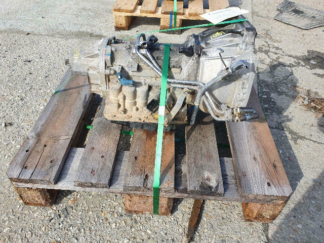

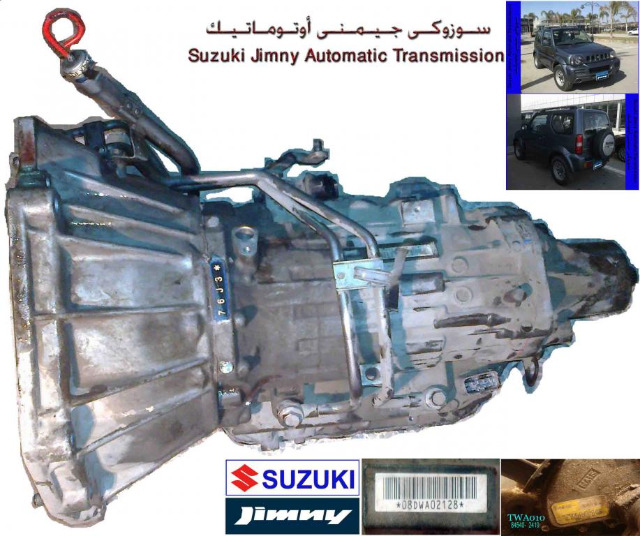

06 Feb 2022 01:20 #241715
by zukebob
Replied by zukebob on topic JB74 auto breathers.
My previous reply was based on a relatively longstanding "truth" from another forum. I have since come across additional pictures of a Gen3 auto (TW40) showing a breather at the rear of the transmission. I still believe it is the same transmission on the Gen4. Attached are the pictures.
I apologize for the earlier misinformation.

06 Feb 2022 11:42 #241720
by Roger Fairclough
Replied by Roger Fairclough on topic JB74 auto breathers.
I would be very surprised if the auto did not have some sort of breather as although ATF is not supposed to froth, there will be an increase in air pressure due to heat and that needs to be dealt with. The picture shows a feature that looks like a breather and is where I would expect a breather to be, so maybe!!!
As to where to exit the breather, I took mine high up in the engine compartment and capped it with a small motorcycle fuel filter.
Roger
Roger
